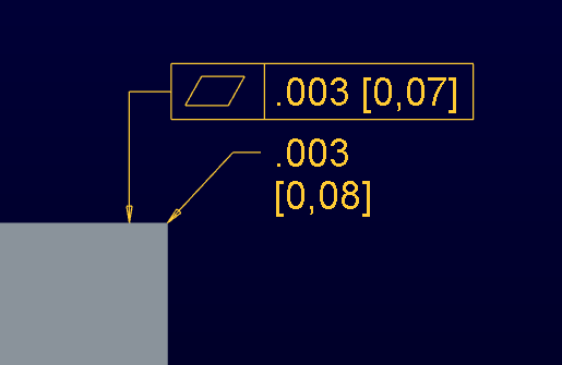

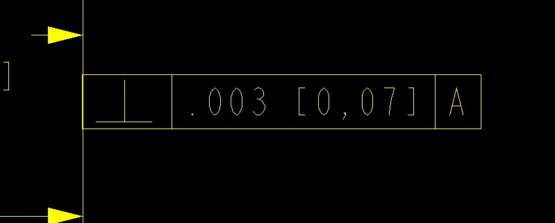

I'm dual dimensioning a drawing on 3.0 and running into an issue when adding a GD&T block where my primary - inch tolerance is to 3 places. I need the secondary - mm tolerance, to display two places, IE: .003[.08]... I achieved this by using dual_digits_diff in the options, but my problem is that it just cuts off everything after the second place in the [secondary]. This is what it's displaying ".003[.07]". Essentially, what I need it to do is round up from .0762mm to .08mm. Any ideas?

Antonius, I get the same on regular dimensioning, but I'm talking about within a GD&T block..
The Primary is set to 3 places but the secondary is just cutting off the digits past two places, so instead of rounding up to .08mm from .0762, it just displays [0.07]

August 21, 2012
I think I know the answer to this one...
I'm guessing this is a maximum limit.
Your primary dimension is inches, .003.
If the secondary dimension in mm was shown as 0.08, that would be .00315 - but this is greater than the max tolerance you've specified in your primary dimension.
Therefore, to 2dp the mm dimension can only be 0.07, otherwise it could be out of limit per your primary dimension.

Why is it that dual dimensions round properly, yet GTOL dual dimensions truncate the secondary dimension?
I will let the image speak for itself... ref - .0030 [0,07620]
GTOL_ROUNDING_ERROR.PNGmodel annotation shown.

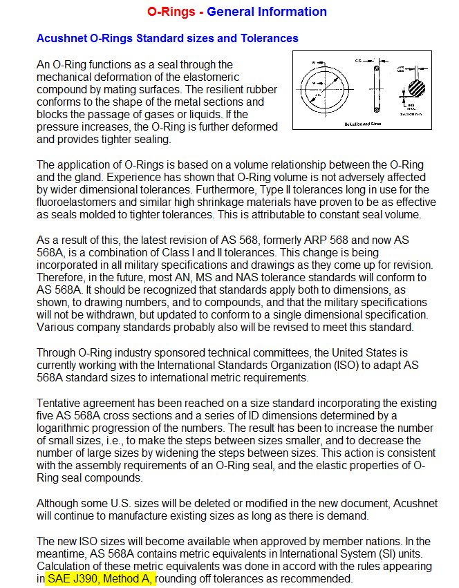

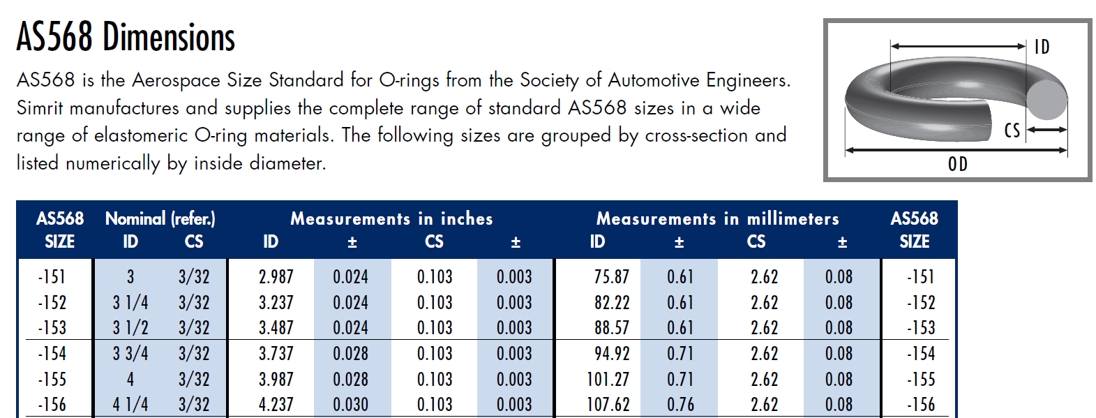

A little more research shows that dual dimensioning is governed by SAE J390 (1999).
Does anyone have access to this standard? Please weigh in as I need more evidence to support the "idea" as a viable config option.
Anyway, I found the following information on All-Seals Inc web site. Please note they refer to "method A" per the standard. Below is their statement regarding dual dimension references and an example of a .003" tolerance.
This document seems to guide ASME more than ISO. But according to these findings, there is a legitimate call for having the option to properly round the value vs always rounding to minimal.
Additional comment added to the Idea.
