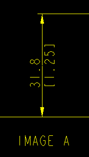

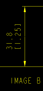

Hi all,
just recently i started working with dual dimension (metric primary, imperial secondary units). I have an issue with just one drawing out of a set of around 15. The issue is how the dual dimension is displayed, i want where possible both values displayed side by side, above the leader line & so i have the config option parallel_dim_placement set to above. Now the option states "does not apply to dual dimensions", but on this particular drawing it does. I have gone through the drawing set-up files for both this drawing & one of the others that is behaving the way i want, & they appear identical. I have attached some screen shots, images 1 & iA are how i would like to display my dimensions, image 2 is what i am getting on this one drawing. This must be a config option i have over looked, any ideas?
Regards
John

November 25, 2011
Hi Ganesh,
yes, i am already aware of this function. The issue is the config option i mentioned, the same setting appears to give different results depending upon what drawing i open. I have the option set to above & on the majority of my drawings i get what you see in image A (which is what i require) but in one or two of my drawings the same setting "above" gives what you see in image B. I use the same drawing option file for all my drawing requirements, so i cannot understand why this is happening.
