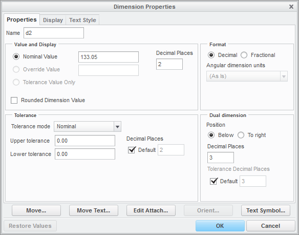

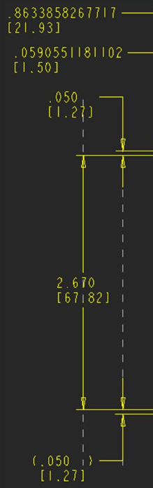

It's hit or miss as to whether the dimensions show up properly, but when the secondary dimension displays incorrectly (with 12 decimal places versus the specified 3), it won't accept any modification in the Dimension Properties dialogue box.

Again, I've tried editing the Dimension Properties, but to no avail:
Here's a snapshot of what the dims look like:

Best answer by TomD.inPDX
click the Rounded Dimension Value checkbox.
