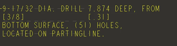

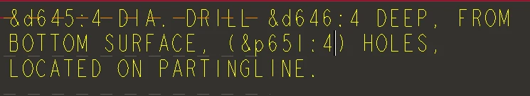

In this image I have my drawing property dual_dimensioning as Primary[secondary]:

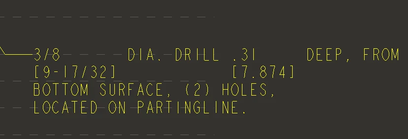

But, when I change the Drawing property to Secondary[Primary], it changes the qty value from 2 to 51:
I don't know if this is a bug or something, but it is not happening in all the files, just a few ones.
Thank you.
