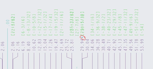

Here is the work around i found:
  • Create the dimension in decimal -> "primary" dimension
  • Create the dimension AGAIN but in fractional display this time "secondary" dimension
  • Drag the secondary to format it nicely next to the primary dimension
  • Hide or otherwise smallen/shrinkify/erase the leader to the secondary dimension... sometimes creo won't actually do anything if you ask it "erase leader" so you have to just drag the leader tip towards the dimension until it dissapears itself (i.e. with ordinate dimensions)
  • Click your secondary dimension
  • Choose "dimension" tab
  • Choose "Dimension text" drop down

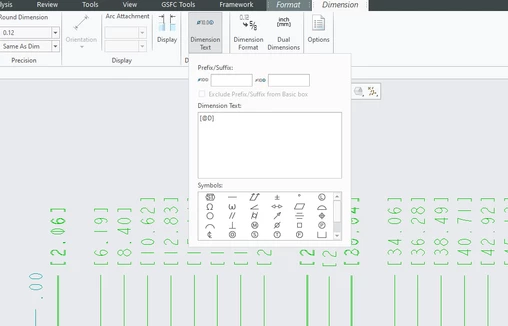

  • Put square brackets [ ] around the @D
Hopefully you'll get something like in the attached image.

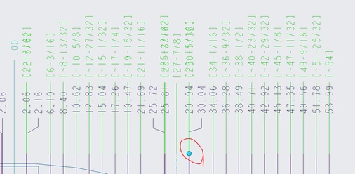

November 28, 2021

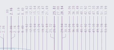

the one downside to the workaround i mentioned, with ordinate dimensions, is if you intend to jog one of the dimensions. you can't hide the jogged dimension witness line by just dragging the resizing ball at the tip of the witness line towards the dimension to make it disappear... oh and "erase witness line", while an available option on ordinate dimension witness lines when right-mouse-button-clicking on it, does nothing.

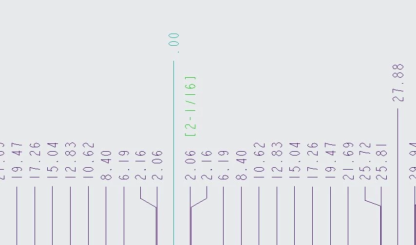

Ordinate dimensions with dual dimensions Decimal [FRACTIONAL]

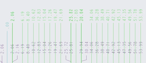

1. Setup your ordinate dimensions as normal. Make them look all nice
2. Repeat the same ordinate dimensions again based on the same zero (select the “.00” icon before you start ctrl+clicking the various locations again)
3. Ctrl+click or click and drag to select all your NEW dimensions together.
4. Go to the top bar “dimension text” and enter square brackets around the @D so it looks like [@D]

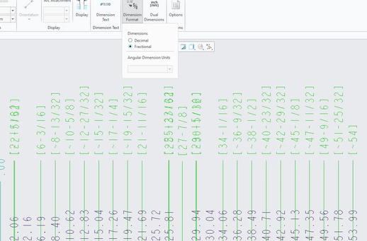

5. Go to the top bar “dimension format” and select the “Fractional” radio button

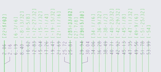

6. Now hover your mouse over one of the new “secondary” dimensions you have created until the double-arrow shows up, indicating you can reposition the dimension along the leader line. Reposition the dimension so it is reasonably close to be considered visually associated with the “primary” dimensions.
7. Now move the mouse to the bottom of one of the leaders until the leader-resizing blue ball shows up at the tip of the leader. Click and drag the leader resizing blue ball in the direction of the dimension until the leader tip is approximately where you want the start of your new “secondary” completely disappears
The one issue that I still have yet to resolve is the jogged dimensions. You can’t hide the leader for a jogged dimension. Hence why in the above image the “secondary” dimensions corresponding to the jogged “primary” dimensions are overlapping their neighbor. “hide witness lines” is useless here. Literally does nothing. If you right click a leader on an ordinate dimension and select “hide witness lines” it does nothing. Even though it is NOT grey out and IS fully selectable.
