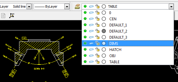

And this is what I get:
As you can see, Creo exported layers and added part number names in front of map_layer names. This is because "intf_out_layer" is set to "part_layer". There are also some of the layer named DEFAULT_1, 2 and 3 which have entities that are not specified in dxf_export.pro file. This is my guess.
I found setting "intf_out_layer_rename_table" but I could not find anything on internet on what this is and how to use it.
So, is there any additional settings that I should set to get layers as set per dxf_export.pro file? Also, what other map_layer values I am missing in this file?

I might suggest that a client who is this particular also has a routine that assures compliance. Maybe they have a script that can do this once the DXF is opened in their system.
As for the default names, what about renaming them to one that is used? If nothing else, you could just remove these lines from the DXF file. You will likely need Autocad to confirm your output files. If you simply import it back to Creo, you might just get more "artifacts" than the file brings in.

If you don't convert all the drawing views to drawing entities, then you won't be able to add their hidden lines to a specific layer.
Actually, I'd like to stop you right there, and tell you that dimensions can't be converted to draft entities. So you will be stuck with those going to ACAD layer "0" as long as you have to set the config intf_out_layer set to none.
Back when I had to solve this I tried to figure out the layer rule as well, and couldn't find any.

I do not want to change dimensions to draft entities. Actually, I managed to place all dimesnsions, tables and notes on one layer. Customer's request is that dimensions MUST be associative, not draft entities.
DIMS layer shown:
DIMS layer hidden:

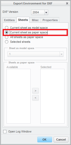

Hello 2 all. I have some questions about dxf export settings.
I need to add this option to my config.pro by default, but i don't seen this option in option list.
To check this option creo doing:
mapkey(continued) ~ Select `export_2d_dlg` `ExportOptions_Tab` 1 `Sheets_Layout`;\
mapkey(continued) ~ Select `export_2d_dlg` `SheetOpt_Group` 1 `current_paper`;
