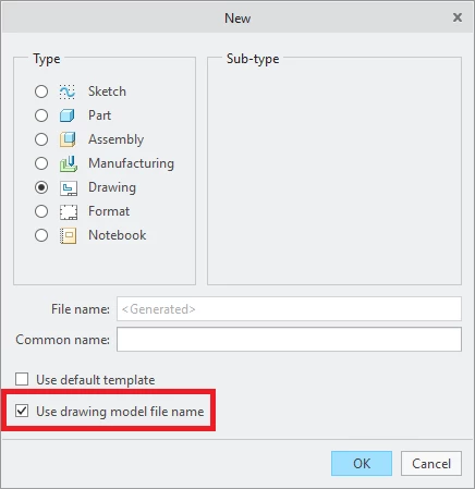

Is there a way to quickly create a drawing file of a part without having to manually enter the part number and description?
Using Creo 4.0 and Windchill

You will have to give the drawing a filename. If you have the part active at the time the drawing is created, creo will assume that the model you have active is the model want in the drawing.

You might want to clarify, are you referring to the intial drawing creation where you give it a filename and ptc_common_name
OR
Are you referring to filing out the title block of the drawing? You can use parameters within the part to fill out the title block.
Your organization would hopefully have that stuff set up already.
March 29, 2019
We have the parameters auto fill the title block so that is not the issue.  It is the creation of the actual drawing.
What I am getting at is when I create a part, I enter part # and common name, then save.  Then to create a drawing for that part I just created, I have to  file-new-drawing and then enter the part # and common name again. Seems redundant, wastes time and can lead to errors.
