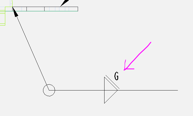

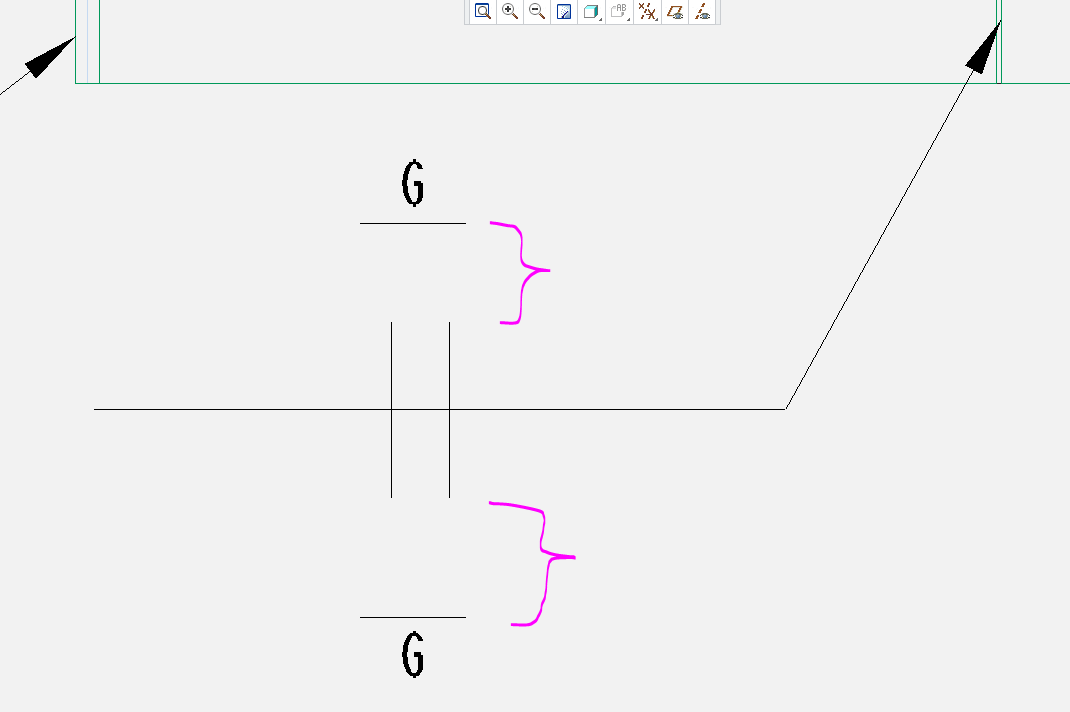

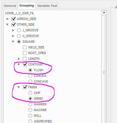

If I use this weld symbol (Contour-Flush / Finish-Grind), the distance between the weld and the Grind is too great.
Can this distance be changed/modified and if so can someone explain how? PLEASE!
This placement is much more acceptable (It's a fillet weld)
PLEASE help.
Thanks!

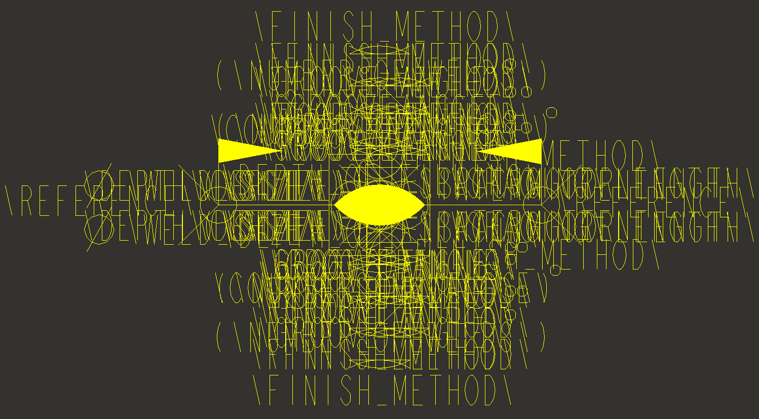

Is this the standard weld symbols that come packaged with Creo? It sure looks like it.

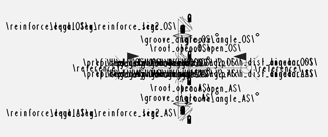

I'm not 100% sure about the pre-packaged welds, for this drawing only, you should be able to the annotate tab, select the drop down arrow next to custom symbol and choose symbol gallery, redefine, pick the symbol you would like to modify and edit the symbol to your liking.
The problem you will likely have is that weld symbols are complicated and creo's symbol editing is horrible, to say the least.

I was looking and it is hieroglyphics

They are awesome!!! I use a custom built weld symbol that does virtually every weld in one symbol...it's impenetrable!!!
StephenW
December 27, 2016
See attached symbol...I thought I would give it a shot. It's not too bad but that simple modification, if you need to use other options like root opening or root angle won't fit right anymore.
I added "_MOD" to the end of the symbol file name so there wouldn't be an issue.
