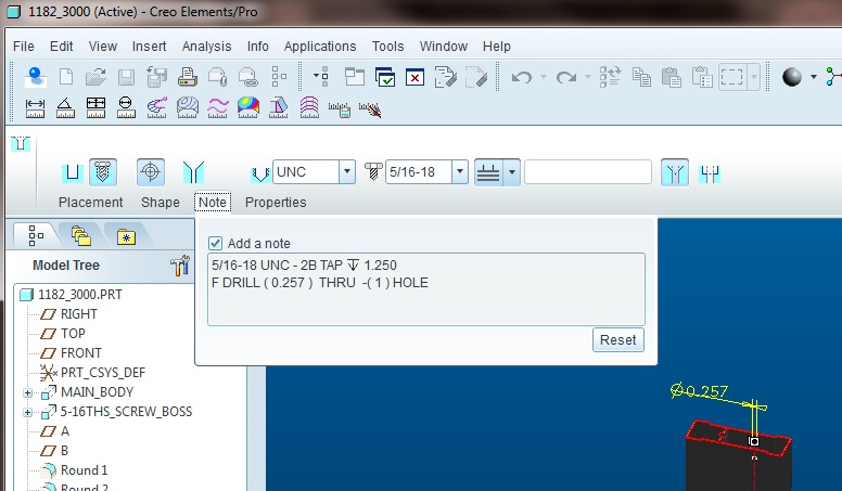

I would like to edit holes notes either in part notes or in drawings notes. After the 1.250 deep note in the first line, I would like to add MIN. How would I go about doing this:

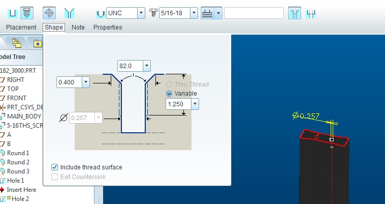

The notes in the part file (I've tried to add it directly in the box, but it's not allowed):
Part file (nor is it allowed here):

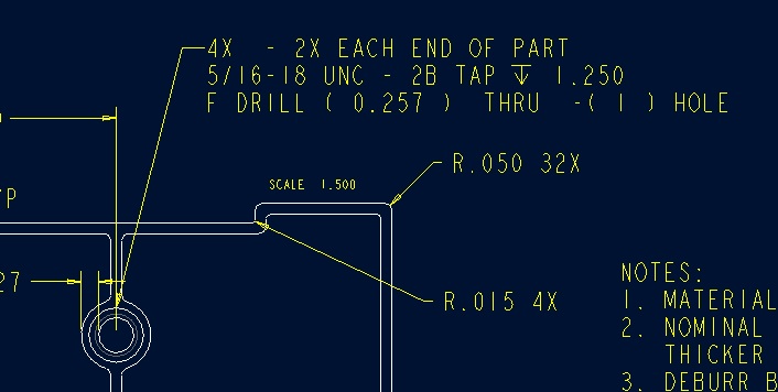

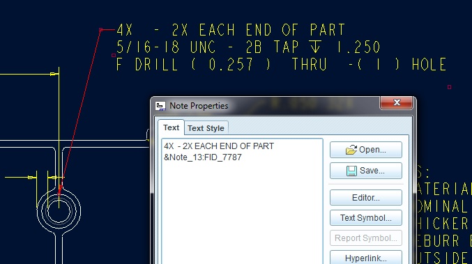

The note in the drawing (this note is &Note_13:FID_7787 as shown in the second picture) is note editable either:
As extra, how would I get rid of the -(1) HOLE - or change it to (4) holes - since I added the 4X at the beginning.

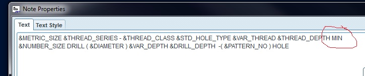

After messing around with it more here is the solution.
Highlight the part of the note:
Then double click and this window will pop up:

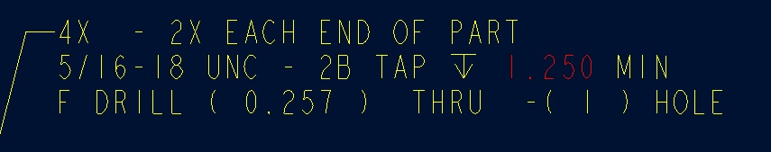

Add the word MIN and then click OK.
Very intuit - NOT!
Thanks for those who were looking into this.
Dale

And to get rid of the -(1) hole, I deleted the {&PATTERN_NO}HOLE.
