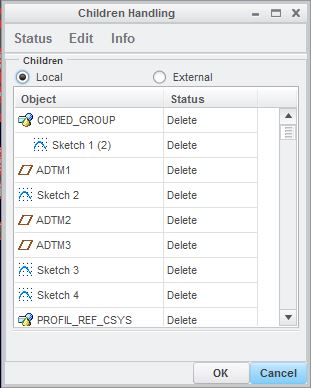

I remember this was said somewhere before, but it's worth mentioning again. There may even be a product idea.
When it's necessary to delete a component or feature from an assembly that has many childern, it's always very time consuming to get Creo to delete just that component, because the status of all the childern objects is set to "Delete" as a default option in the Childern Handling window.
In case of a large assembly switching to Suspend option on each local childern feature could take about 10 secs because Creo tends to hang on this kind of operation.
It would be a good enhancement to have config option such as local_childern_handling_status suspend that could switch all of the statuses at once.
January 22, 2014
You can click the first item, scroll and shift-click the last item, then under the Status menu, pick Suspend or whatever.
Notice that in Windchill each line gets its own check box, with a master checkbox to select/deselect all of them and a separate place to chose the action, so that it is obvious this can happen. The difference between the products is because there is no UI group to look over common functions, like selecting items on lists, to make the same functions work the same way; preferably an obvious way.
January 22, 2014
Ah geez, there are drop down menus on that tab. I've never noticed those.
Thanks for pointing that out, David.

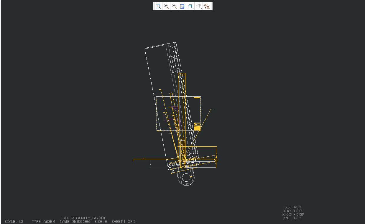

I'm a little late with this request, but this one should be on the top of everyones list that uses mechanism snapshots in drawing views.
Please urge PTC to redesign the snapshot functionality so it's no longer dependent on the explode state software code. The way the snapshot funtionality is designed if a component is changed, any snapshot that references the part becomes out of date and you have to update the snapshots. Let's say you modify a edge radius, but the position of the components do not move related to the change you made. You still have to update the snapshots and if you open a previously saved drawing you can't even see the assembly because the part is scaled in the drawing to show you something has changed. Pleae have PTC fix this. example image attached of a drawing where the cylinder is scaled up 100 times in size hiding an assembly that is 20 times the size of the cylinder.
Current software as designed is causing everyone to do unneccary work on drawings do to a simple dimension change.
Sorry for the rant,
