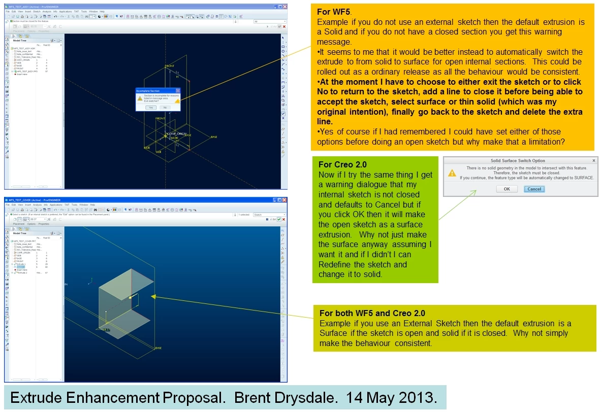

Extrude Enhancement #1
Open and Closed sections in External and Internal Sketches for Extrude
Brent

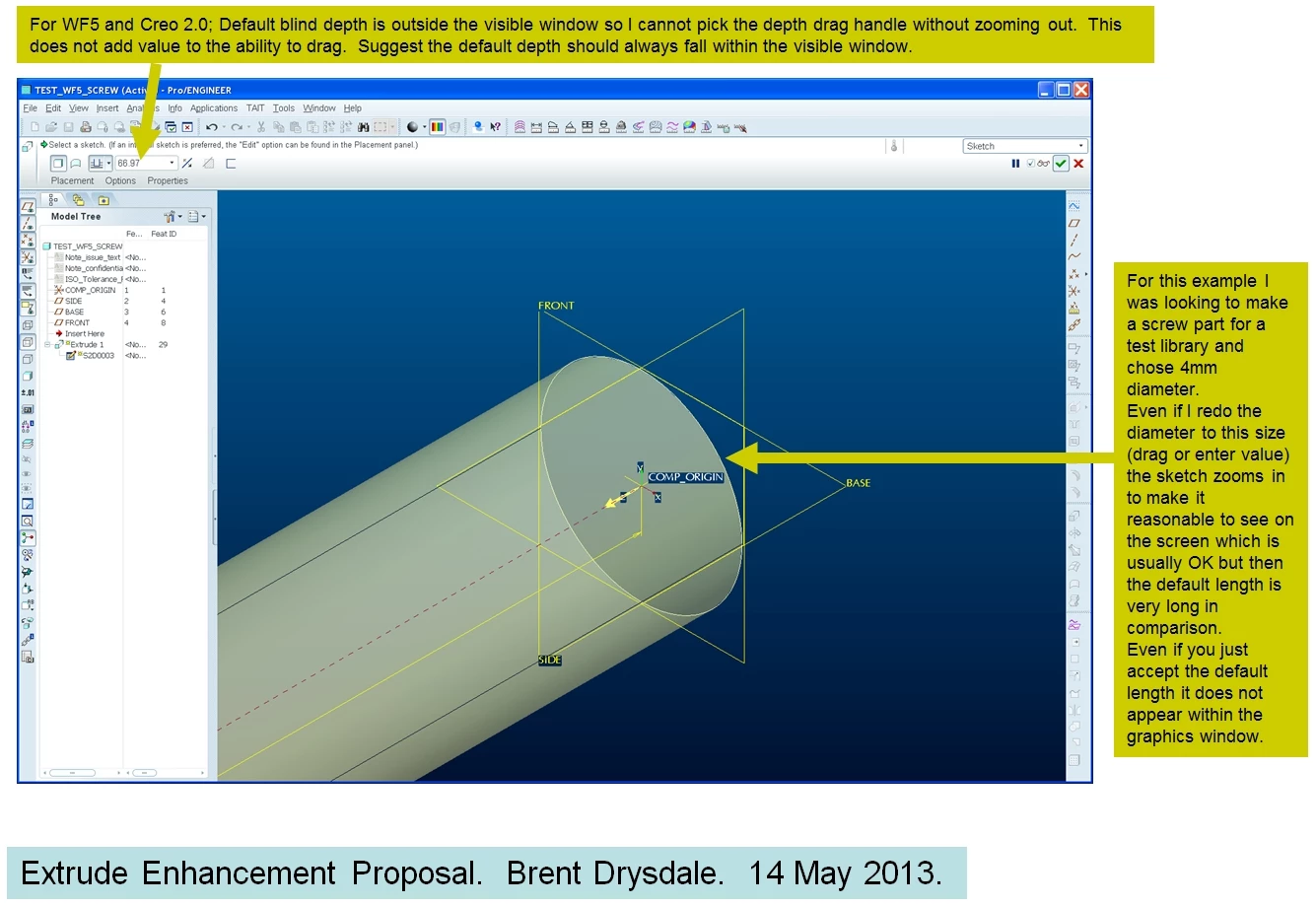

May 14, 2013
Extrude Enhancement #2

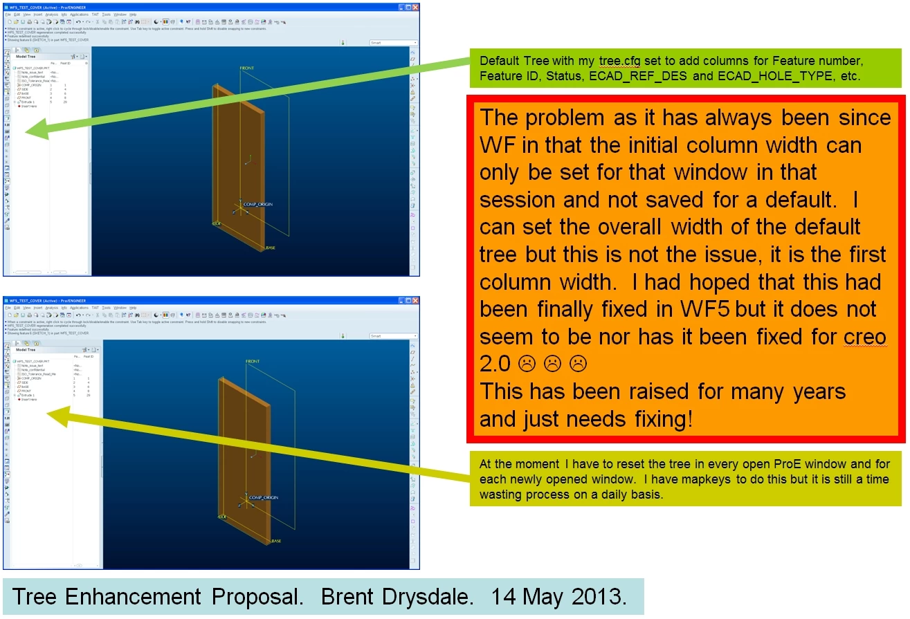

Tree Enhancement
May 14, 2013

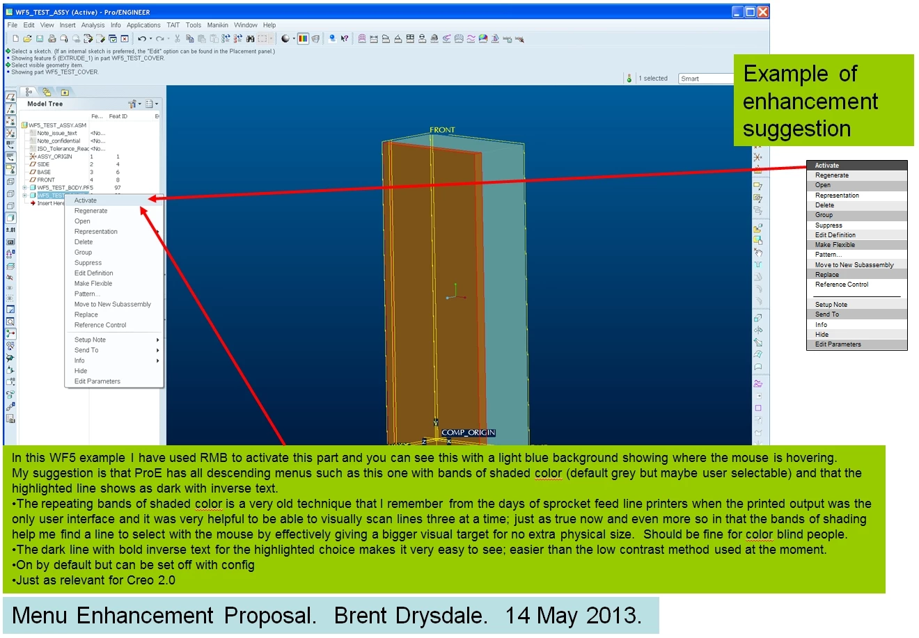

And finally (for now)
RMB/Menu Enhancement
Happy commenting
