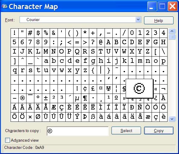

Here's how you put a special character into a note and dimension.
Here's how to get a proper copy write symbol character into a ProE drawing or format.
* In windows pick Start, All Programs, Accessories, System Tools, Character Map
* Change the font in the Character Map window to Courier. (it's the most universal.)
* Hi-Lite the Copy Right symbol and pick the Select button at the bottom of the window.
* Then pick the Copy Button. You can now paste this into a note in ProE.
[cid:image001.png@01CBB97C.9B8CF2A0]
