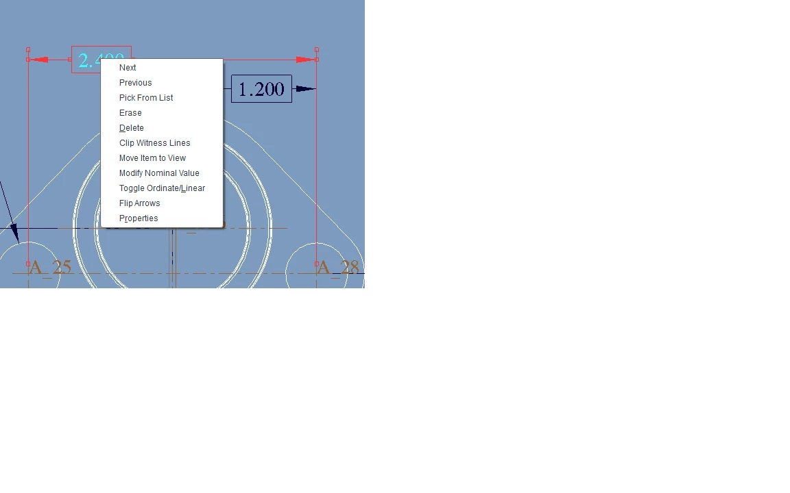

Right clicking on a SHOWN dimension on our drawings, we have BOTH a "ERASE" and "DELETE" option avaliable. I would expect to see only an "ERASE" for a shown dimension.
When you select "DELETE", you can then reshow the dimension through the show model annotations dialog box.
When you select "ERASE", the shown dimension goes away... and you can't get it back. The dimension is still in the model, but you can't do anything to reshow it in the drawing.

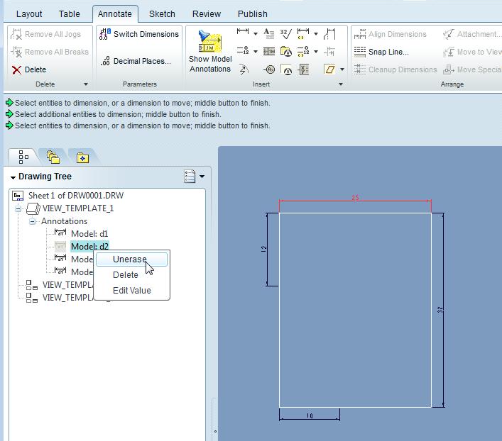

I'm not actually using WF5 so I can't say for sure but my uderstanding is there should be a drawing view section of the interface that lists the elements of the drawing. There should be a category called annotations that list the dimensions. If it has been erased it should show as greyed out, select the dimension, and then right click>Unerase. However I have been told by some that it doesn't seem to work or doesn't always work.
July 4, 2010
I believe if you erase a shown dimension,
1. you must go into the drawing tree while in annotation context.
2. expand the annotations node for the view it was attached to
3. selected the hidden dimension and delete or unerase
Joe
July 6, 2010
That seems to work. I had not run accross that yet. Good to know, Now, I will be able to answer that question when it comes up.
July 6, 2010
Thanks for the help! This certainly answered our question.

July 27, 2011
When we select "DELETE", we can't then reshow the dimension through the show model annotations dialog box. Is this a bug or I missing something?
July 27, 2011
What type of dimension is it?
