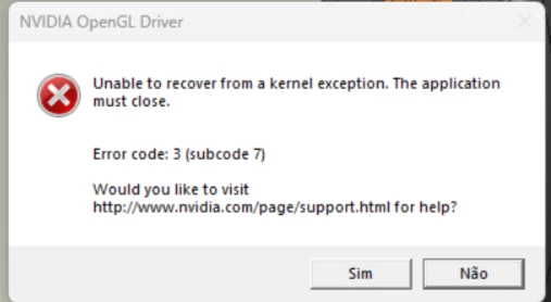

I'm getting an error when running tasks in CREO: ERROR CODE:3 (SUBCODE7). I've already contacted NVIDIA; we've updated the driver, rolled back to older versions, and tweaked the graphics card settings, but the error keeps coming back. The card is a Quadro P400.

Same issue here with new Nvidia Drivers. Several DELL Workstations (from 2019/2020) PTC Certified, are getting the same error in our company.
We went back to 573.48 which is nearly one year old, works stable in Creo 12.4.X
GPU is a Nvidia Quadro RTX 4000

There is a CS article as of March 2026 that has steps to resolve your issue: Article - CS344319 - When using Creo Parametric to open and close files, there is a freeze with NVIDIA OpenGL Driver error Unable to recover from a kernel exception. The application must close
You should be able to log in with your PTC account and follow the steps in this article. RTX 4000 and P series graphics cards are listed as affected cards.

I also need to weigh in on the Creo crash message “NVIDIA OpenGL Driver - Error code: 3 (subcode 7)”.
We (I work for the Liebherr Group) have also been plagued by this problem since March - that’s three months now.
Three different Liebherr companies have already opened cases with PTC Technical Support regarding this issue.
According to PTC, over 50 of their customers are already affected by this problem.
We’re seeing new users every day who are suddenly experiencing crashes with this error.
Some report more than 10 crashes a day, making it nearly impossible to work with Creo (we’re using version 10.0.10.0).
Unfortunately, we can’t pinpoint the cause, and there’s no discernible pattern:
Both Dell and HP workstations are affected.
About 10 different NVIDIA graphics card models are affected.
We’ve already tested countless different driver versions - none have brought any improvement so far.
Various attempts to escalate the issue with PTC have been unsuccessful.
PTC says that only NVIDIA, in collaboration with Microsoft, can solve the problem, so their hands are tied as well.

​@DomenicLaritz :Same issue here with around 20 Creo Users. All DELL Workstations. The only solution which works very well is going back to a Nvidia 57X.XX GPU Driver. All 58X.XX and 59X.XX Version are causing the same crash error code 3 (subcode 7).

We’ve been dealing with this issue since February 2026. We were able to resolve the issue by adding the following variable to our config.pro file:
enable_opengl_vbo no
PTC’s tech support was not all that helpful because many of our laptops aren’t on their “Certified” list. Most of the folks affected here have RTX ADA GPUs. The older, non-ADA GPUs don’t appear affected.

On 30-Jun-2026, PTC Technical Support sent us information stating that we should install NVIDIA driver version 596.36 for the affected users and set the following three config.pro options:
  • enable_opengl_fbo = no
  • enable_opengl_vbo = no
  • enable_opengl_shader = no
The (somewhat older) PTC article CS169272 also recommends disabling these settings if you’re experiencing graphics issues.
This shows that PTC hasn’t made any progress on this issue and is simply trying out various solutions.
However, disabling the three options mentioned results in the graphics in Creo being worse than those in Monkey Island from 1990 - working under such conditions is simply unacceptable for users.
So far, ​@Gian’s tip to use a driver from the 57X.XX series seems to be the best workaround. For 90% of affected users, Creo runs stably again with this.

Same issue here. Never during normal work, but always when the laptop is resuming from hibernate. Too bad, since Creo is just the reason why I use hibernate, it allows you to continue your work exactly where you left of the previous day, without having to wait for minutes to open complex assemblies. :-(
Just received a new laptop and hoped the problem would be gone, but regrettably the issue is exactly the same with the new laptop, it only crashes with errorcode 3, subcode 7 when resuming after hibernation.

According to information recently added to PTC article CS476940, NVIDIA should have resolved this issue (at least for single sessions) with driver version R595 U9.
