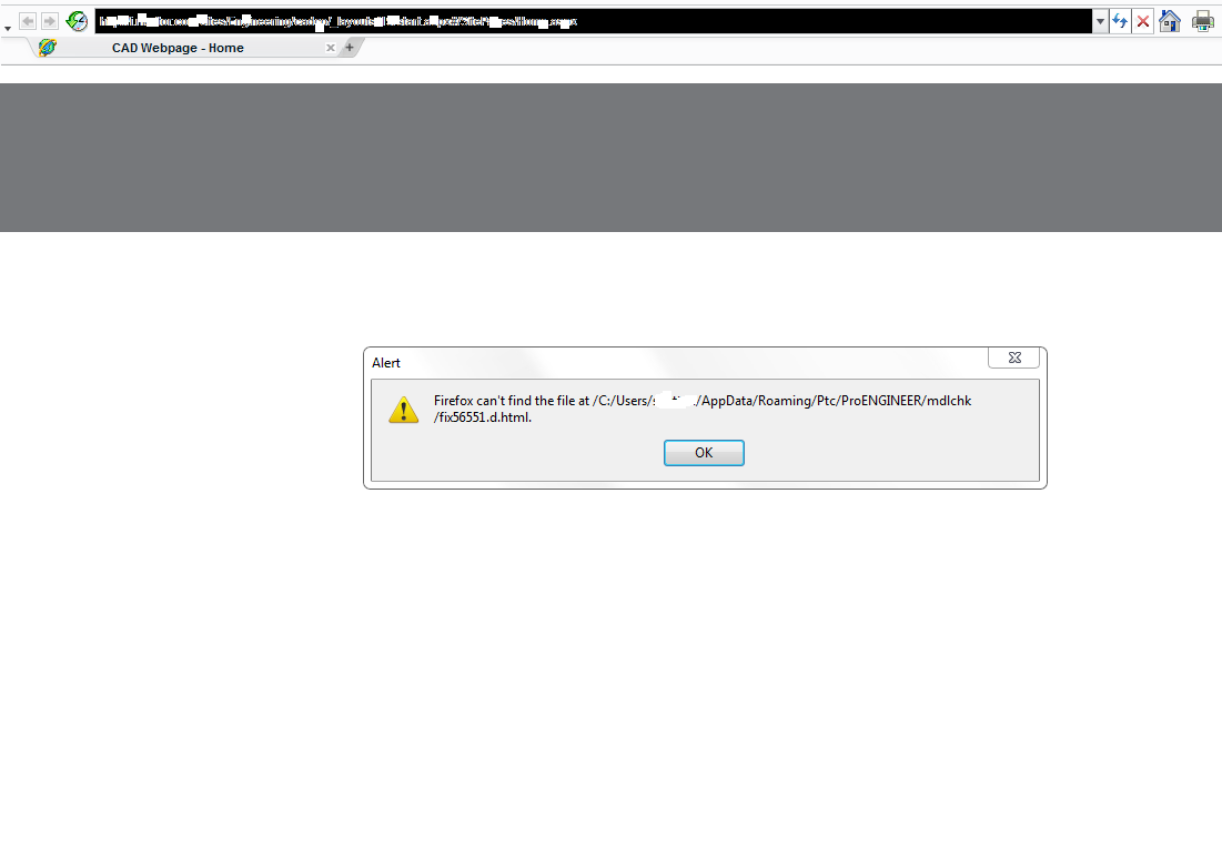

One of the user is having an issue using ModelCHECK in Creo 2.0 M180
There is an error message after the modelcheck is run and the report is not displayed:
Iam not able to understand why this error when other users don't have such issues.
Any response appreciated.
Manjunath

Manjunath,
Specified error will prompt when defined location as in warning is not available on machine. Check the Dir_report in config_init.mc to reports directory.
