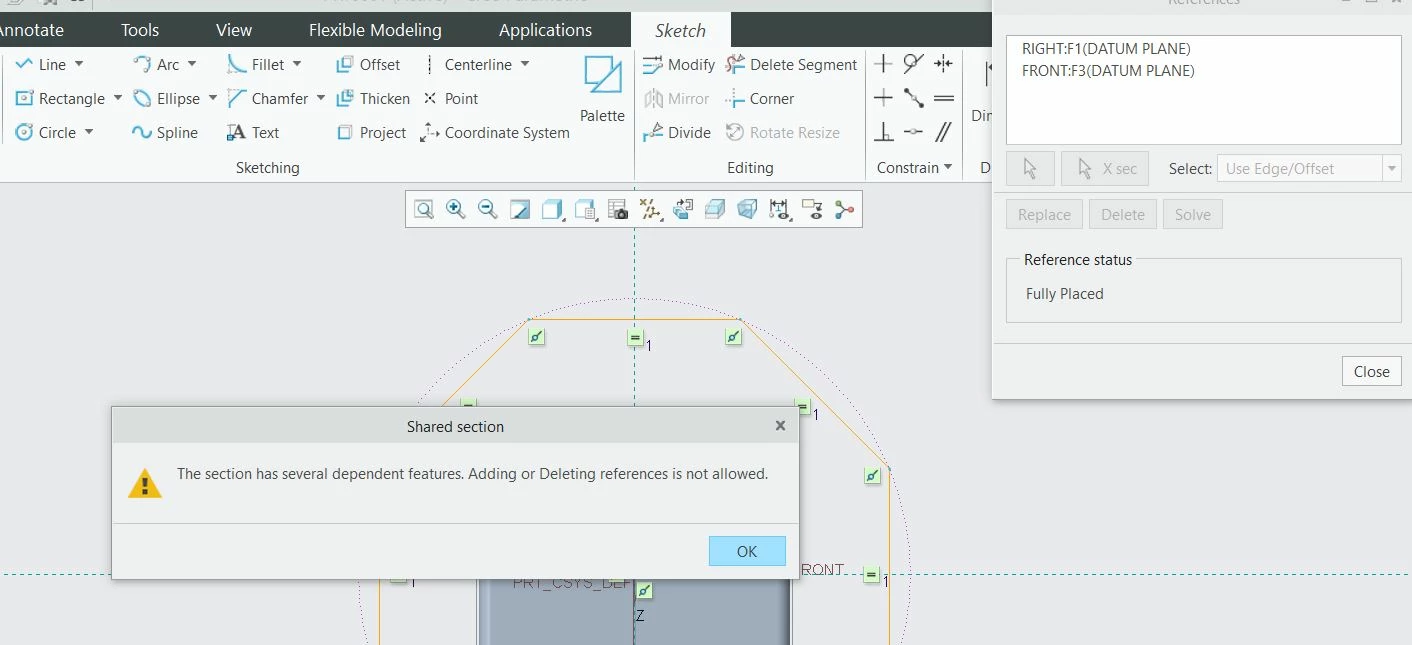

Error: cannot add/remove references in the sketch
I encountered this message (attached) that informs me I cannot add or remove references in the sketch and the reason is this feature has many dependents. This is the first time I see this. I used to be in control of my design intent by redefining and rerouting my features any time and resolve any subsequent failures. Have anyone seen this? Thanks.

I have seen similar messages when redefining a feature that has dependent copies. Is that maybe what you have here?

to figure out what features have become dependant upon the feature you wish to change, & try changing the references of those. Not always possible but sometimes you get lucky.

I have to admit I didn't know that at the time I posted this but I found out this message comes up (cannot edit sketch references) if the feature is mirrored. I had to delete the mirror, rededfined and re-mirrored. It makes more sense to me to be able to redefine a feaure that is mirrored and the mirror updates.

This is another thing PTC should fix instead of giving us the rubbish that are ribbons. Why should we have to delete mirrored or dependent copied features just to dd references. Of note, you can REPLACE references in sketcher.

I get around this by mirroring geometry instead of features. So instead of selecting the feature to mirror, select the surfaces (using Seed & Boundary, usually), copy-paste, mirror the resulting quilt (you can mirror the copy feature, but I prefer mirroring the quilt), then solidify. You get a better and more stable mirror that's easier to redefine, and you can change references in your sketches as much as you want. If it's a lot of features that you want to mirror, it results in a smaller feature count and quicker regeneration, too.
