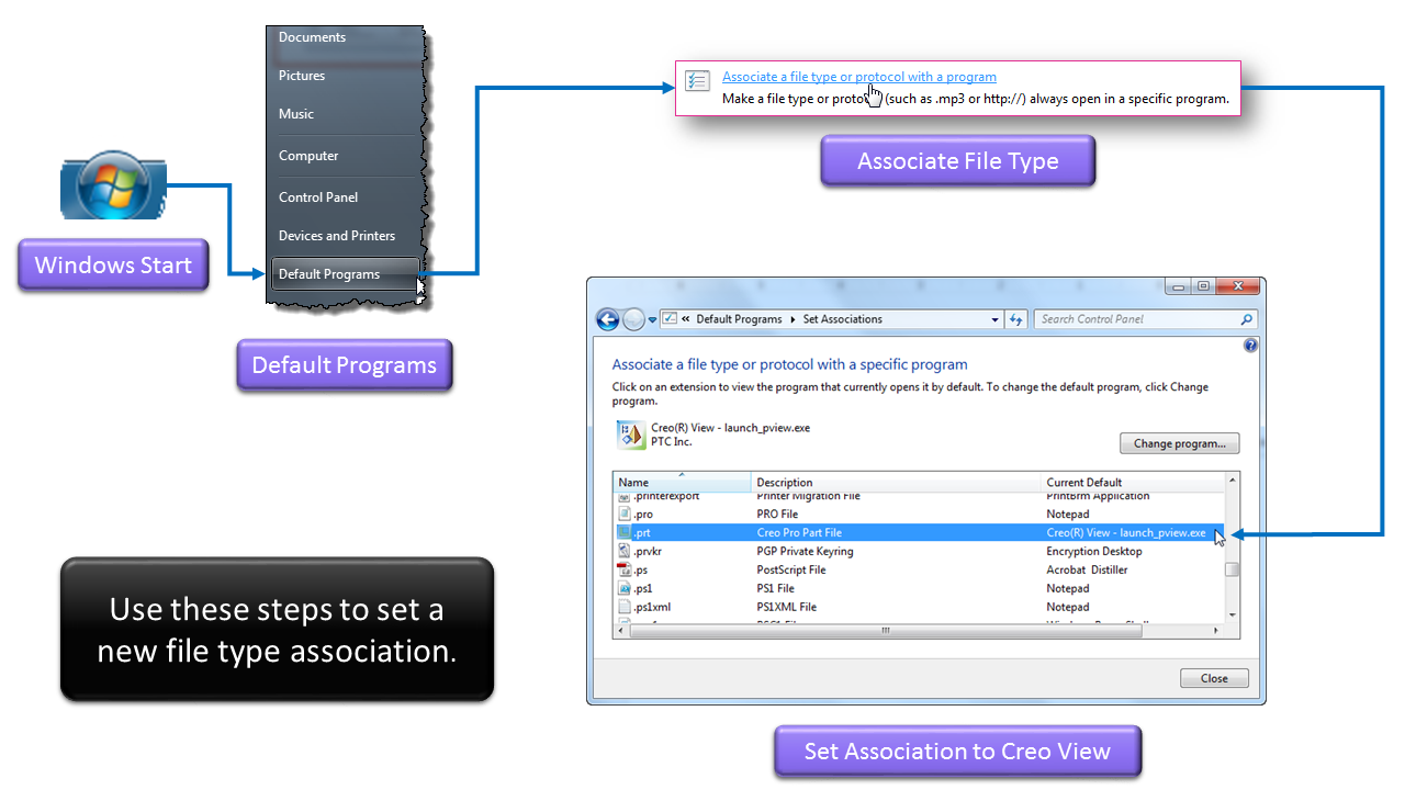

Hi Jignesh,
It sounds like you just lost your file type association. This is easy to fix. Try the steps below (or use the slide which attempts to provide some screen grabs to help you).
  1. Select Windows Start
  2. Select Default Programs
  3. Select Associate a File Type or Protocol With a Program
  4. File the file type you wish to associate (.prt in this case). Select Change Program.
  5. Browse to your installation of Creo View. Select launch_pview.exe as the default application for your file type. Select OK.
  6. When you double-click a .prt file (or open a link to a .prt file), Creo View should now launch.
See the slide below for screen grabs (click the picture for a larger image).
I hope this helps!

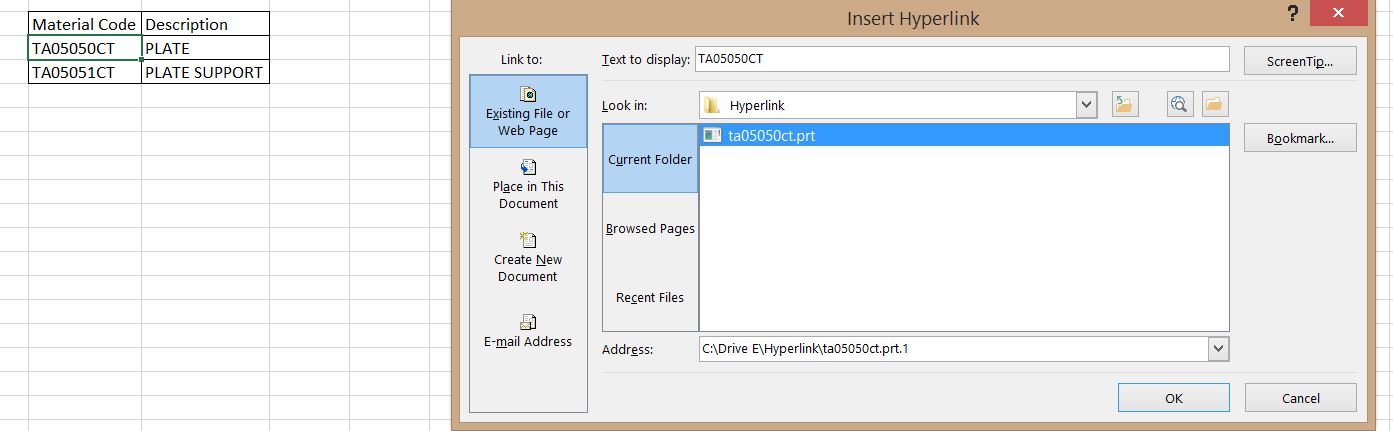

July 10, 2014
Hi Martin,
find below screen shot as you can see i have code and it's description
