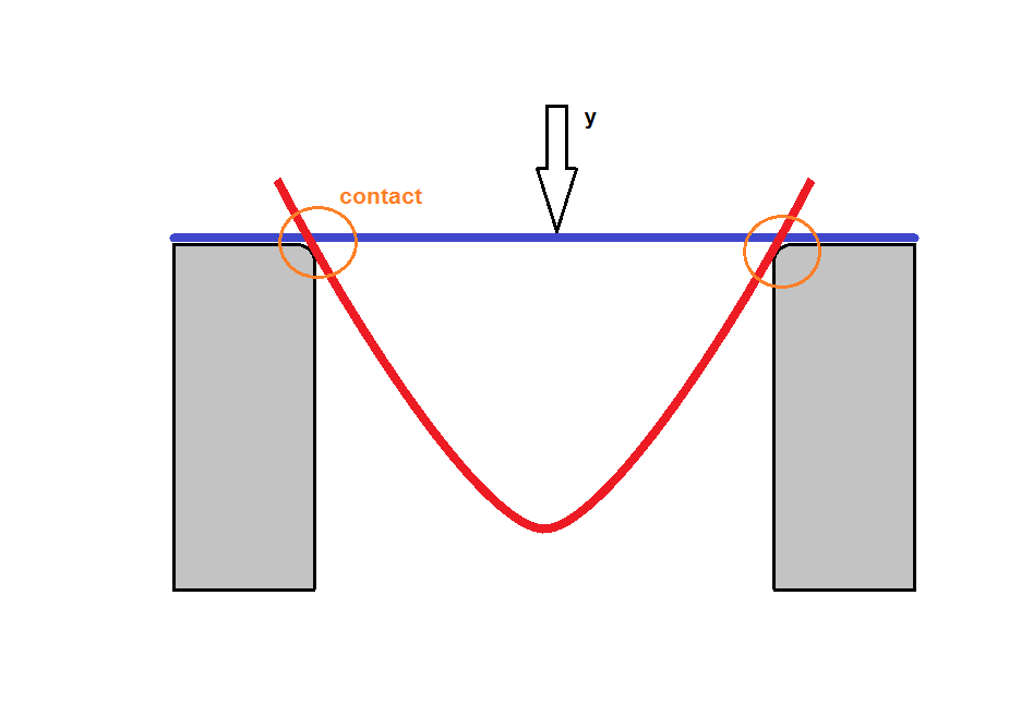

I have a simulation including a stationary body and a moving body. There is a contact between them. I often see the warning: "Excessive displacement at contact region". A software suggests smaller time step but I can not reduce it. The full moving process is described with 100 step and the software does not allow to define more...
1. What does it mean exactly the excessive displacement at the contact? Is the time step too large compared to distance between two mesh nodes? If I increase this distance (element size) - instead of time step reduction - is it correct?
2. How can I define more steps under "User define output step"?
Thanks a lot your help;

1.Refine the elements of the contact region and have a try,sometimes it's hard to converge for the solver when the elements are too large.
2.Before it contacts each other,you can give less steps,then you have more steps for the contact steps.
3.You can only define less than 100 steps with a non-linear anaysis.

OK,thanks, I understand. My main problem is the "max 100 time steps". I have a quite long moving process and I should divide the full process to small steps but the 100 step possibility is not enough for me...

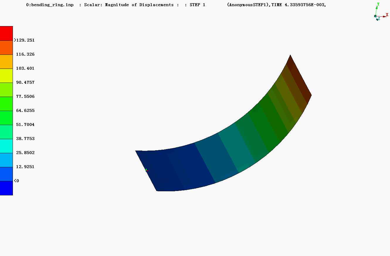

Creo can do this large deformation analysis(below),so I think your question in not a problem.

his problem is plasticity and contact and large deformation.
regards
paul
ps:
contact+large deformation: OK (example attached)
contact+plasticity: OK (example attached)
contact+plasticity+large deformation: not possible

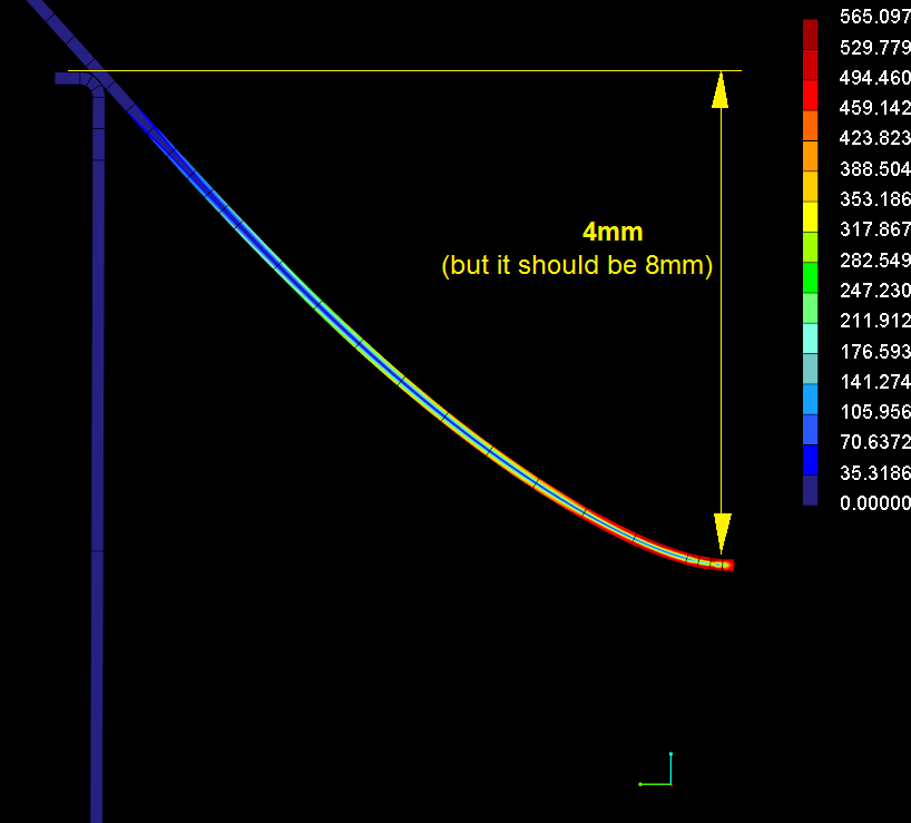

My task is very similar to your 2. example (contact AND large deformation). But my model includes plasticity.
As far as I see, the main problem is that the time step has to be small because the parts are in contact continuosly. There is no a range during the motion process where the time step can be increased because the calculation will diverge in this range...

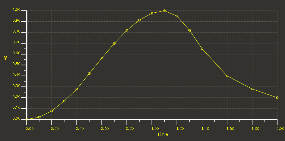

Second problem is that I has to calculate the backway of blue part. So my motion function (y in time):
I would like ot investigate the final state, after the springback. If the time step is large after the maximal y then the contact will not be correct. Finally, I should divide this full timerange to 100 steps and it seems to me that it is inpossible with correct time step size...

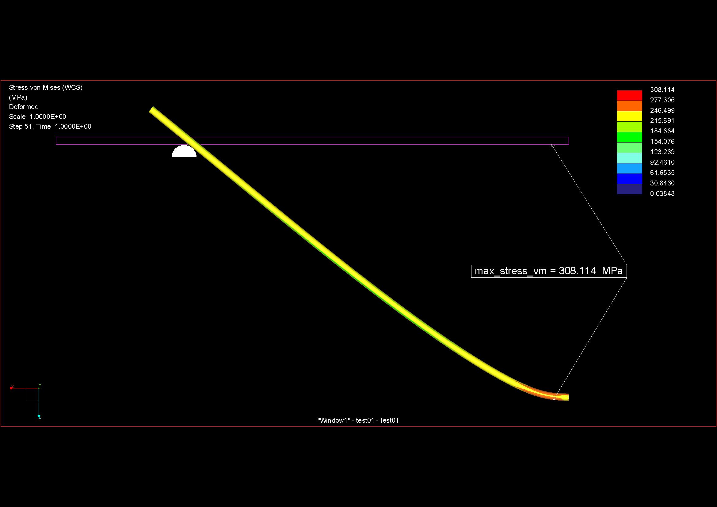

OK,
example attached (contact, large deformation and plasticity).

OK, it is a perfect example. My testcase includes plus 2 additional problems:
- the motion (down) is more higher so the plastic deformation is more larger too
- it should be modeled the backway of rod (to see the backspring) so I need additional time step but the 100 is not enough
The simulation is ok with 4mm displacement but the 8mm...
