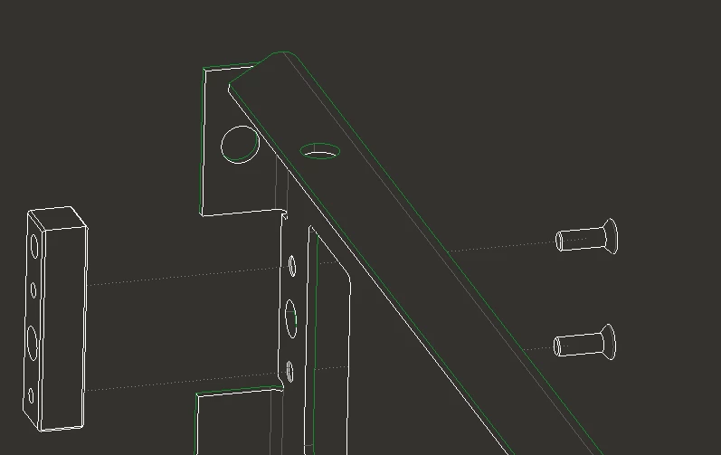

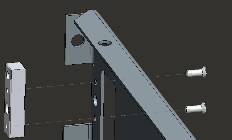

I have a problem with the lines of an exploded assembly when I represent a exploded state in a drawing in a shaded mode. The lines are always at top-level even if they are hidden by another part (see pictures). This problem does not appear in other view modes.
Anyone can help?
Thank you,
Thierry

Hello and welcome to the forum.
It appears that only hidden line removal will change the state of the extension lines in exploded views.
It seems silly to not use the hidden line state for shaded image. This would be a simple algorithm change for PTC. Maybe you can post this as an Idea.

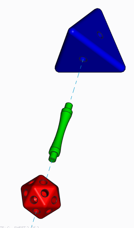

I just came up with a work-around if this is important to you.
  • I created an exploded view and extension lines in the assembly model. These lines are called "offset line" in the model tree if you show the features.
  • Assign these offset lines to a layer in the assembly model in order to hide them easily.
  • Save your preferred orientation for the drawing view.
  • Open the drawing, place the view and edit the origin of the view (to some nice round number).
  • Change the view display to No Hidden (this will trim the extension lines).
  • Create a new view set to Shaded (no-edges) located at the same origin.
  • Switch the drawing tree to layer tree and set the layer to the shaded view name.
  • Hide the layer you created with the Offset Lines on it (this will hide the layer only in that view).
Now you will have a shaded view with a no hidden overlay which trims the extension lines.
