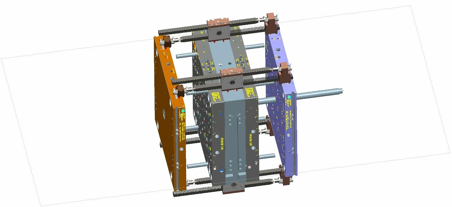

Nice work around
I used a Datum curve to define an envelope to work within, exploded view is now stable, but I’m still a bit shaky
And yes the curve can be hidden to clean up the screen

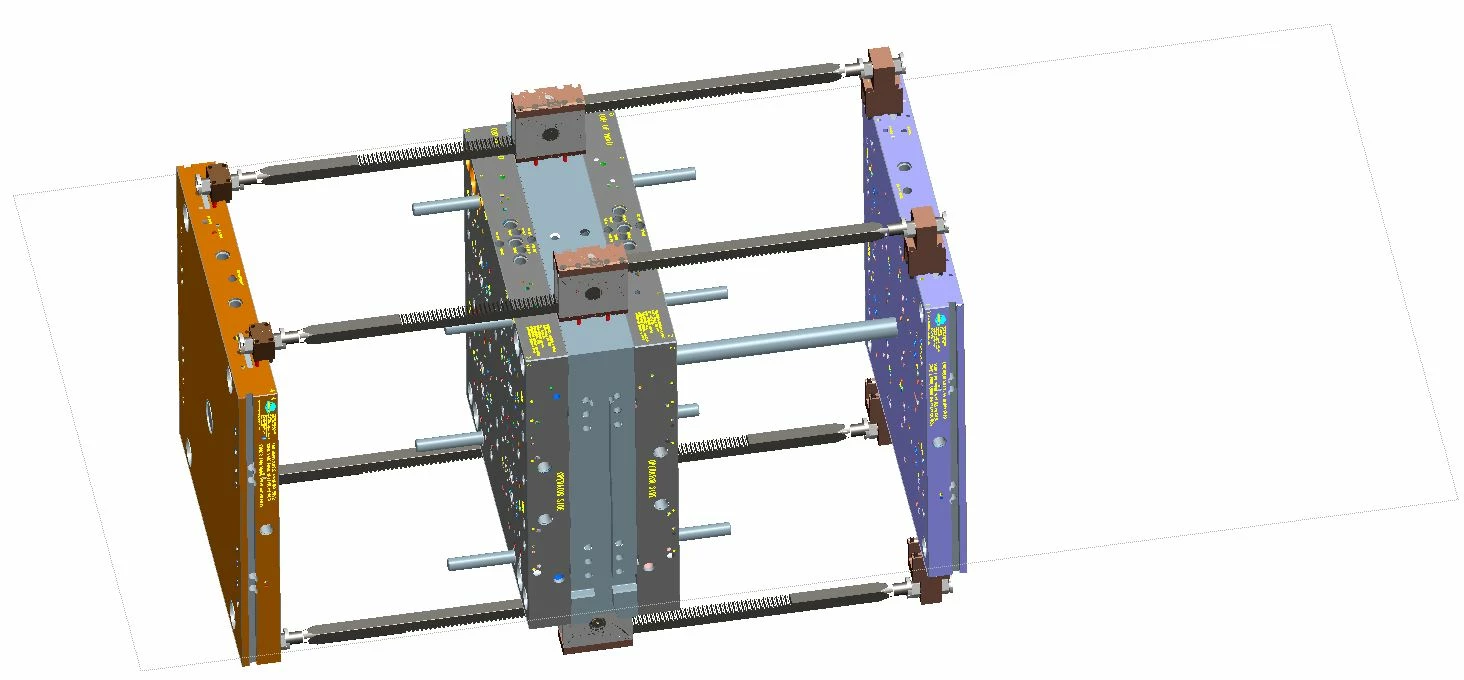

Sample images attached for your viewing pleasure
Thanks for the tip Dave
<jscott>
Jeff Lippeth ▪ Mold Design Engineer▪ NyproMold▪ P 847.855.2226
July 30, 2012
So when I said a huge cylinder, I meant really huge. The assembly should look like a dot in the center of it. I believe that will cure any shakes you have.
