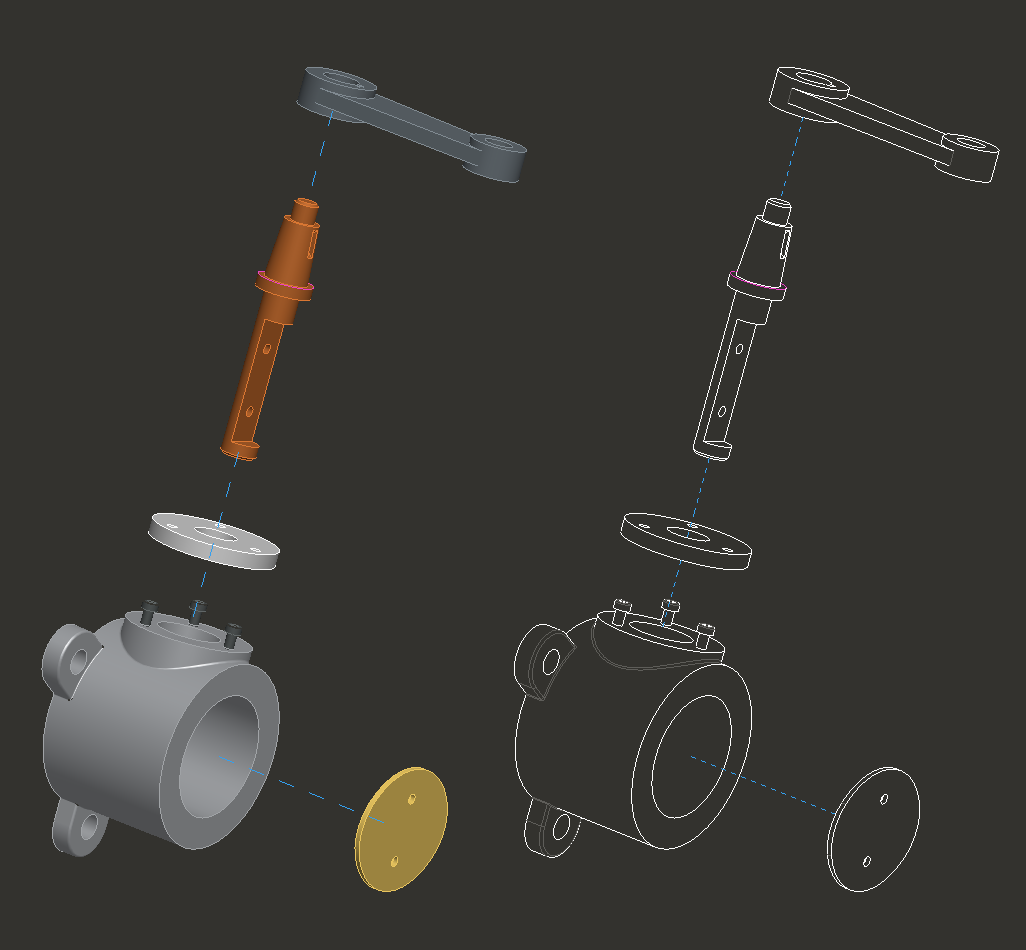

To start off I'm working in WF4. I'm trying to make an exploded view with offset lines and put it in a drawing. I have actually acheived this, however WF4 does not like the fact that I'm attempting this with a shaded view.
I've created my exploded view and offset lines and saved the configuration in the view manager. When I insert my view in the drawing and set the Display Style to 'No Hidden' everything works as expected. The problem comes in when I switch the Display Style to 'Shading' the offset lines only show when the model itself is in the exploded state. When the model is in its default state the offset lines in the drawing go away. A further problem is that when I print the drawing to pdf with the shaded view the offset lines print VERY thin and light so you can almost not see them. When I print the drawing in the 'No Hidden' display style the offset lines show up the same blue dashes as in the drawing when I'm working in WF4.
Does anyone have any idea of what's causing this inconsistency? I've contacted PTC and they haven't come up with any solutions at this point.

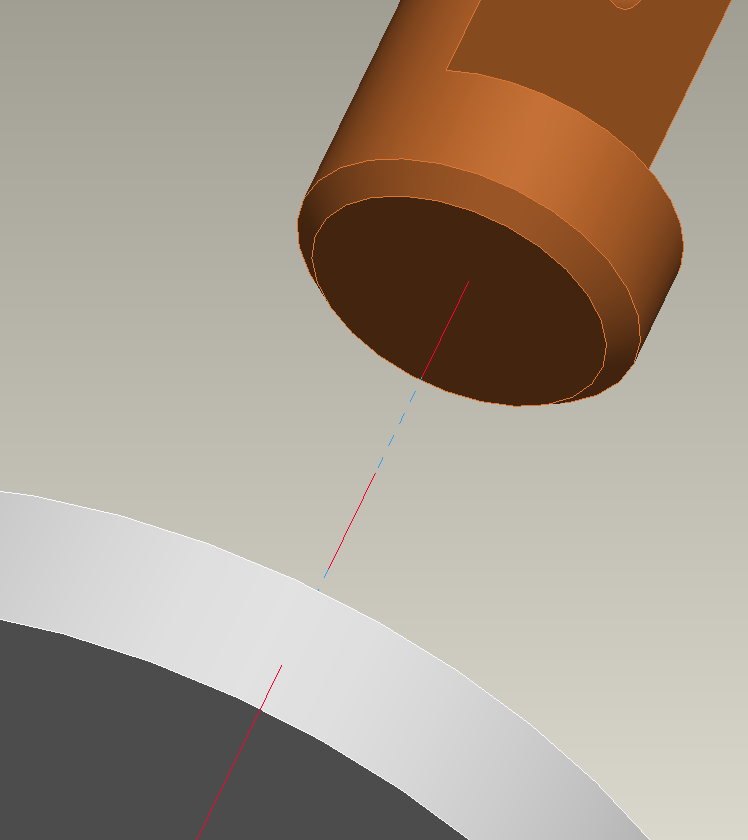

While I appreciate the attempt, I have already performed the tasks you've stated. I tried to make that clear in my original post. I have already made a new Explode state in the View Manager that contains my Offset lines. I'm also already using a pen table, however, it doesn't appear that any of the pens in the table actually control the line weight of the Offset lines.
I have a little more information on my issue. When I have the drawing style in "Shading" the Offset lines show up as Dashed lines like they do in the model but seem to print as hidden lines. When I switch to "No Hidden" the Dashed lines turn into what looks like Hidden Lines but print as Dashed lines. I have no explanation for the line style changes but it's a little more information.

Hello
Lines are controled from Exploded states - default lines for Offset lines - two deferent lines in assemble mode, that appear at necessary view - Shading, No Hidden, Hidden, Wireframe:
In drawing mode it is same - two deferent lines dependent on view display:
