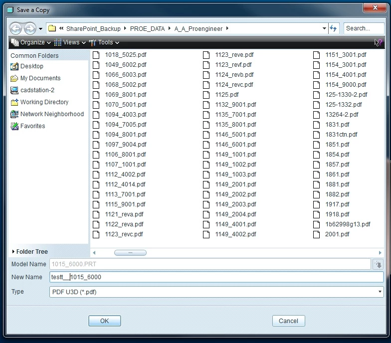

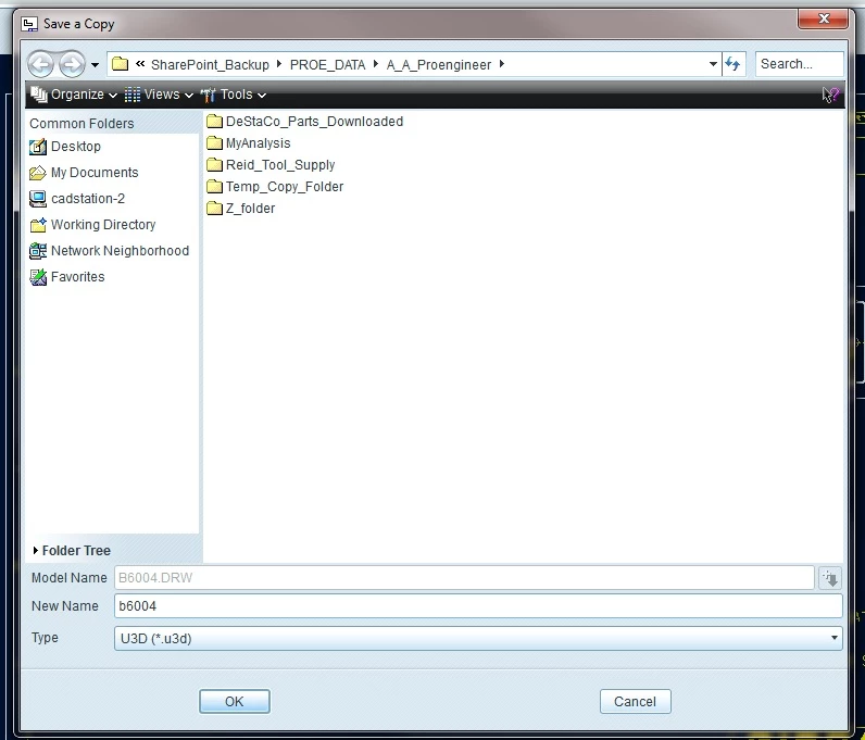

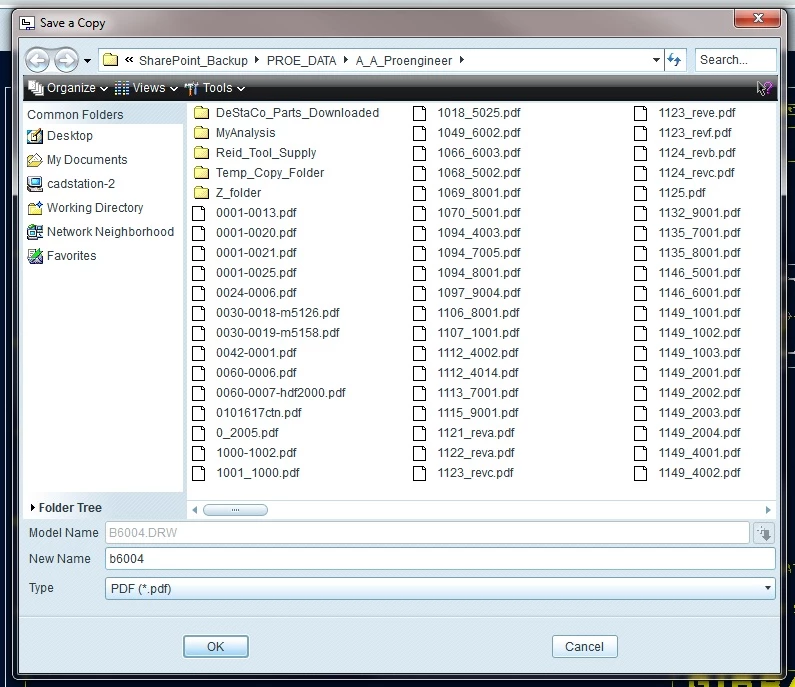

In the Wildfire 5 help menu it says that to publish a 3D PDF, you click "Save a Copy" and choose "PDF U3D" in the 'Type' box. But for me the option isn't there. I've seen evidence of the option in Wildfire 4 although I haven't installed it to check. Was the option removed or is it part of an add-on? I'm just curious since seeing the notes on it.
Best answer by Dale_Rosema
I noticed that the "PDF U3D" is available when you are in a part file and the you can do either "PDF" or "U3D" when you're in a drawing.
I not sure if this answers you questions.
Thanks, Dale
Thanks, Dale
WF5/Creo
