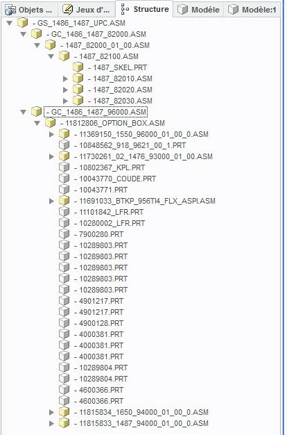

I would like to know if it's possible to export or to print only the structure of an assembly ? Not the model.
In attachment there is a screen capture of what I need to export.

You can export a TXT file of the model tree. Set the filters (tools/tree filters) in the tree to show what you want so if you just want parts and assemblies uncheck features and other things you do no to want to show. Expand the assemblies you want to show the parts within. In Model Tree Tools drop down "Save Model Tree" and it will give you a default name of "treetool.txt". Change the name as you would like. This will save a TEXT file in you working directory. This will be a list of the model tree indented, but no icons on the left that indicates a part or assembly or feature, etc. You can then open the file in WordPad, Notepad, Excel and other programs.

This is totally possible in Creo View. With the assembly open, select Tools tab, Bill of Materials, Generate BOM, Export icon.
The output file can be a .csv or html

Ok, I confirm I'm able to do it with Standard or Mcad version. I'm disappointed because it's not possible with Lite version. export bill of materials is hidden.
