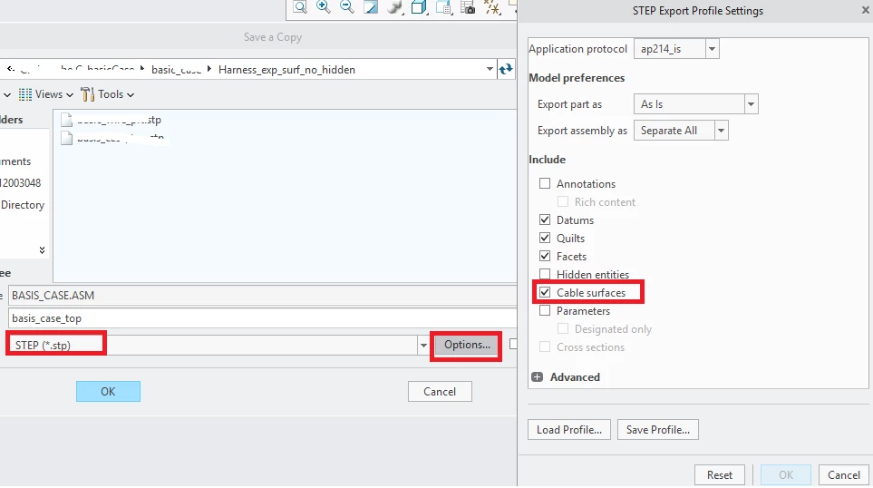

When I have done this in the past I have exported as a step with surfaces turned on instead of solids and its worked without any issues.

Yes, it is working well to export harness part as surface (no solid)
Please check the picture which was done in Creo 4 M060.
