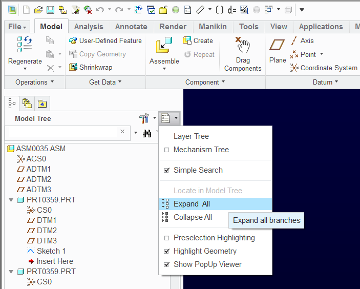

Would this help?
mwick7-BedrockAuthor
7-Bedrock
July 1, 2014
To some degree it does, but it also expands the features under the part as well. I am looking to generate a Bill of Materials from the Model Tree. So I basically need the part number, title, rev, quantity, etc.
July 1, 2014
Right; you want to set up the tree and save the tree configuration to show these parameters. You can turn off the features for assemblies (tree filters). You can add columns for the parameters (tree columns).
Again, if you want to import these into Excel, plan the tree carefully as spaces in any field will get in the way. Maybe add these to the end.
