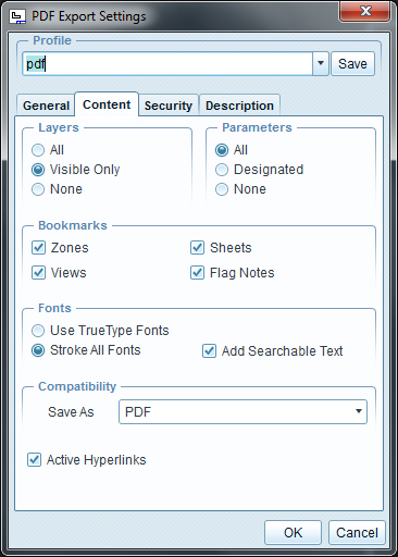

Hi
Im using WF5.0. Whenever I try to export a drawing to pdf, the position of the text obtained are different then the drawing.
This problem is resolved by changing the settings fwhile exporting by checking "stroking all fonts".
I just want to know that is there any config options present to change this settings permanently so that everytime I
do not need to change the settings while exporting.
I have tried changing the config option "intf2d_out_stroke_text" to all but did not seem to work.
Please help
May 6, 2011
Hello
If you plot drawing to printer you can set configuration options:
ttf_handling_for_plot_files stroke all fonts
This setting applies only for publish drawing to printer. For pdf export does not exist configuration options (if I know) which sets stroke all fonts.
Note:
1.) I recommend to you create mapkeys for PDF export setings (stroke all fonts).
2.) ... or you can create custom setings:
Have a nice day.
