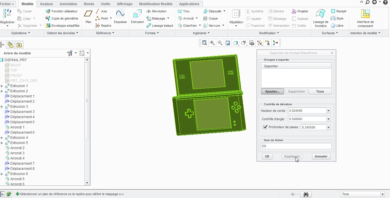

Hi all,
I have a big question for you:
I used Creo Direct 2.0 to model a piece, and I wanted to export it in the .obj format. But I saw that .obj export isn't availavle in Direct 2.0. So, I decided to import my set in Parametric and to export it in .obj, but Parametric doesn't allow me to do this .
I don't understant why !!!
I'm able to export pieces I model from parametric, but not pieces I import in Parametric.
Help me please !!!
Sincerely ...............Alexandre.... you really need you
May 7, 2013
I found my problem, I forgot to choose a plan for UV-Mapping, but I have another question :is it possible to make uv-mapping in color with parametric, because it's always gray
Thank you
