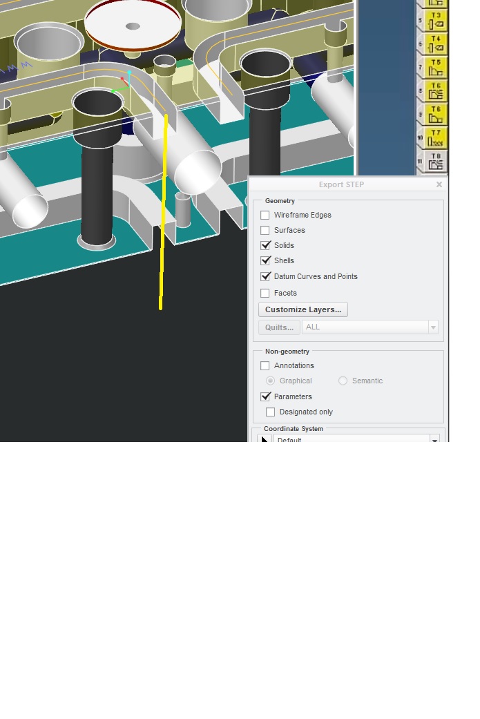

Hi.
How to export a model to parasolid with curves? (I don't mean Wireframs edges)
Can't find parameters like export to step.
Best answer by BenLoosli
Parasolid is a 3D solid model file format, it does not support curves. If you need to export curves and solid bodies from Creo, you need to use IGES or STEP.
BenLoosli23-Emerald IIIAnswer
February 4, 2015
February 17, 2015
Ben's response is correct.
