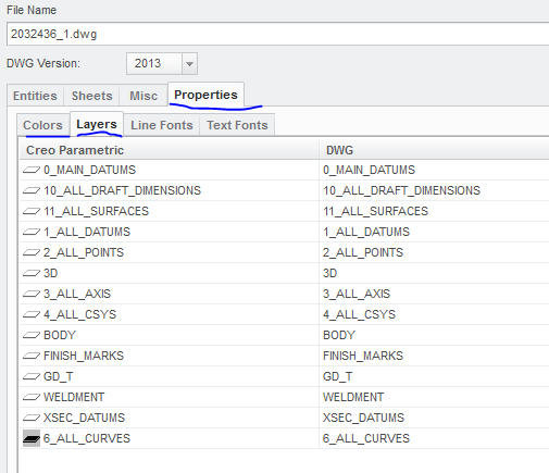

hello people
i have a question
i use creo for 3d , i create 2d and after i export an another program not matters what program is
i interrested how export in a layer of another program
how create a block in creo 2d and export them? all the same block
tks
Best answer by bshepherd
>FILE>SAVE AS>TYPE:DWG>OK
bshepherd10-MarbleAnswer
June 25, 2015
