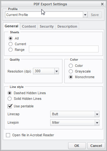

We have to supply certain customers with multiple page drawings in PDF format, but they want the pages as separate files. Creo do offer the option to export to PDF all pages, but he makes it into a single file.
Anyone is aware of a simple way of exporting mutiple page drawing into multiple PDF files?

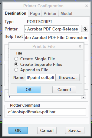

Hi
You just need to choose Create Separate Files instead of Create Single File in the Print to File screen.

Hi Sarah,
to be honest I did not tought of going the printer way, but will give it a try. I see that you are running a BAT file as your plotter command line, is there anything special to use "fake" printer to generate the PDF. We are not using Adobe, but it should similar.
I was trying to go trough what Creo offers as a direct export to PDF.
In that last panel even if I select all pages, Creo do not offer to create multiple files.

August 20, 2014
Hi Alexandre
The printer I'm using is not Adobe it's CutePDF as I mentioned before.
You install CutePDF then it directs you to install GhostScript (this is what does the actuall conversion)
then you need a .bat file like this
@echo off
rem ** Get the plot file name and location from the command line.
set INNAME=%1
rem ** Change the .plt (Change to .ps if you are using that extension) to .pdf for the output.
set OUTNAME=%INNAME:.plt=.pdf%
rem ** Start Ghostscript, make sure that "C:\gstools\gs?.??\lib" is set in your path.
rem ** and "C:\gstools\gs?.??\bin" is set in your path.
rem ** For NT this is setup in: Control Panel + System + Enviroment + path.
REM ** call C:\gstools\gs5.50\ps2pdf %INNAME% %OUTNAME%
call C:\gs\gs9.05\LIB\ps2pdf13 %INNAME% %OUTNAME%
rem ** Delete the original plot file.
del %INNAME%
rem ** Move the file to a release directory now.
move %OUTNAME% c:\plotfiles\saved\pdf
and then make a new printer in Creo the .pcf file should look a bit like this
button_name Adobe Acrobat PDF Corp-Release
button_help Adobe Acrobat PDF File Conversion
plotter postscript
plotter_command c:\tools\pdf\make-pdf.bat
paper_size A3
landscape_plotting yes
delete_after_plotting no
plot_file_dir c:\plotfiles\saved\pdf
plot_sheets all
plot_destination file_and_printer default
