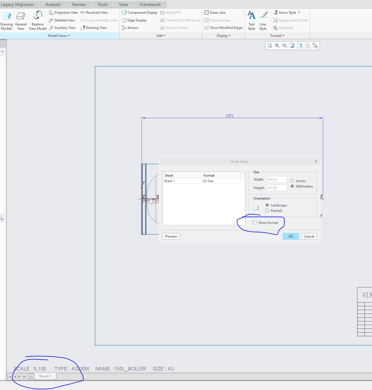

We have a new batch of CNC programmers for our sheet metal parts. They asked me if I could export the DXF of the flat pattern without the drawing border. I guess the experienced programmers have always removed the 4 lines of the border.
Is it possible to export a DXF of a drawing without the border? (geometry only)
Is it possible to export a DXF of just the drawing view? (possible workaround if the above isn't possible)

Why don't you just export the model as a DXF file. No borders, no scaling, no notes, no dimensions, just the 3D model. Most sheet metal packages take that and flatten it into a 2D view anyway.

You have probably solved this (it's been six years now) but I'm answering in case someone else wants to know.
Below the drawing window there is a ribbon. On the left it say Sheet1, right click on that and select Setup. Then uncheck the box that says Show Format

Jan 30, 2018 1:20 PM UTC
Much better way to deal with that problem then deleting the formats. I'm actually going to test if I can do this in my sheet metal start part.
I've been looking in to mass exports of DXF's and this was a bit of a problem.
