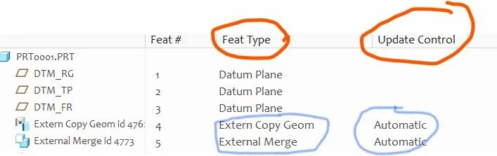

Instead of using reference viewer which gives you a detailed breakdown of external references in your file, you can make use of model tree columns for a quick glance :ext.jpg

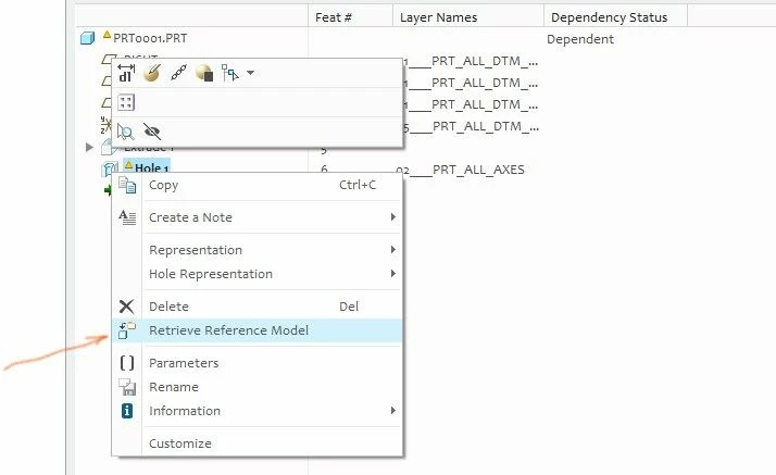

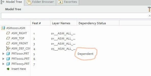

Try this if this solves your issue:
1. In the assembly, add "Dependency Status" to the model tree. You will see the word "dependent" next to prt0001:
2. When you open up prt0001 w/o assembly, you can always right click to retrieve its reference part/assembly:
