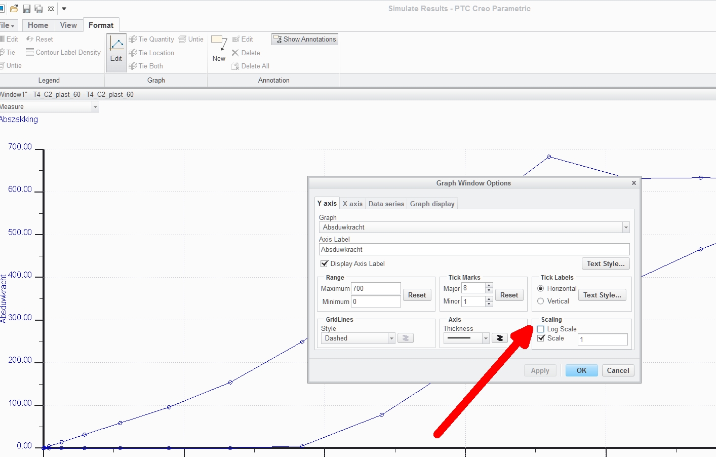

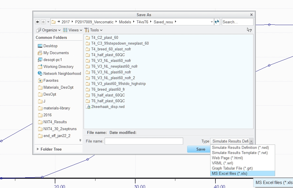

Is there any way to extract the measures data to a csv file?  Also, when I plot out the measures, is there away to change the axis from linear to log?

You can save a graph as an excel file (file, save as, select excel in the box right below)
You can change the axes like this: Format -- Edit
change each of the axes to log scale
