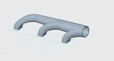

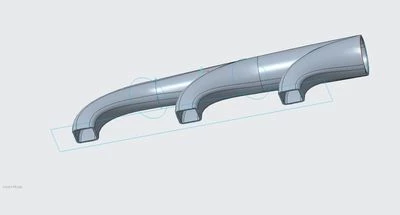

I want to add an  Extrude of 10 mm at the bottom of the model without affecting the openings created with shell command present below.  In Creo, there is no multi body function so I am unable to do so. Please guide me how to do it in Creo 4.0

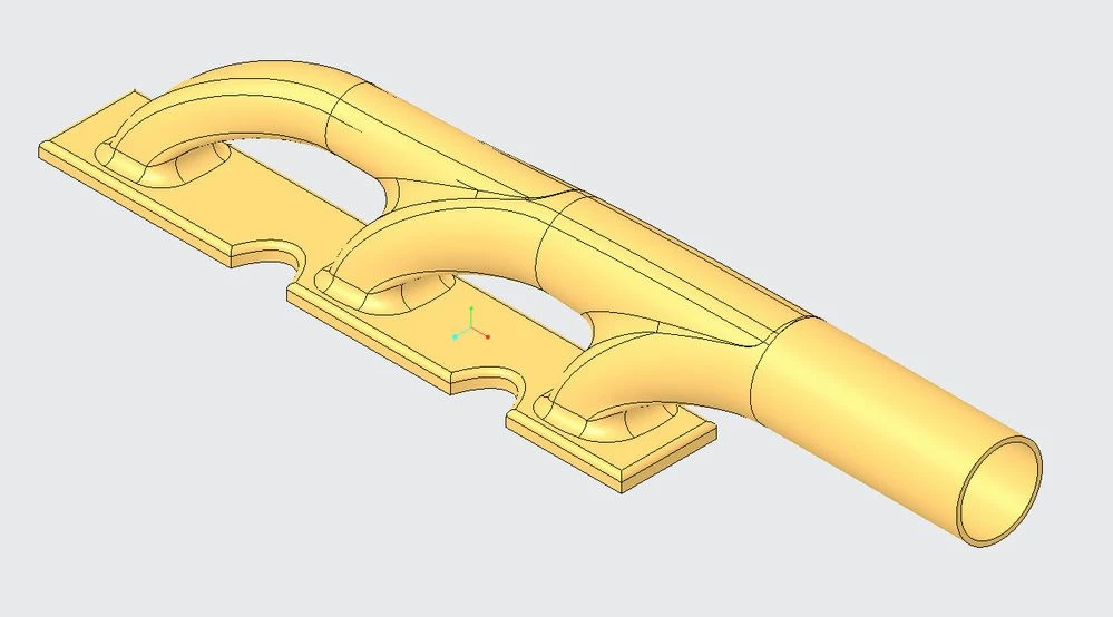

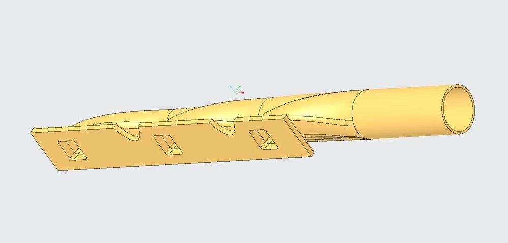

I managed to create it. First I extruded the rectangle then created the cavity along the previous shell using the Blend tool.

Regarding your original approach, the extrude could have been made as a capped surface, the internal surfaces of the 3 outlets copied and extended, the copied surfaces merged with the extruded surface and then solidified.
