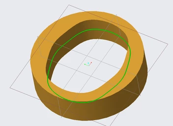

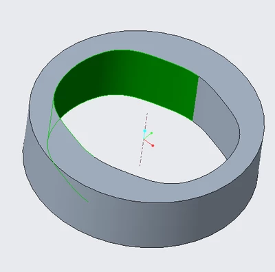

I would like to know if there is a way to avoid Creo splitting a surface into two surfaces (see picture)
In this case, I created the outer geometry and subtracted the material in the middle.

Maybe. Post the model or explain the connection about the symmetry plane of the inner cut. It appears there is a dihedral angle where they meet at the symmetry plane.

Hi tbraxton,
I've imported a table of datum points to create a curve (in green), and used the curve to cut the geometry:
I mean, the same thing happens when I cut it with a circle:
why does Creo do this?

Cylinders in Creo have always been split in two.
Though I am not certain of the reasoning, I sure there is a logic answer from a programming standpoint.
