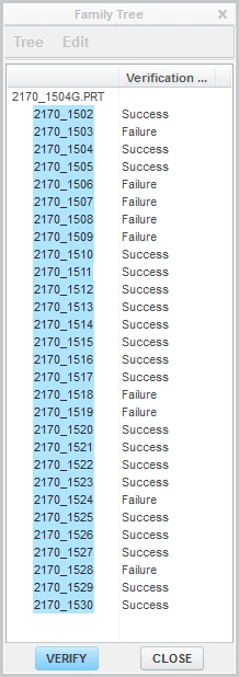

Often when creating family tables (of parts that get larger in length and associated patterned features), I find that the model accuracy causes a number of issues during the verification process. While the failures often occur in patterned UDF features... random rounds, chamfers, and other basic features also often fail in random instances during the verification process. Could someone please explain how best to handle these issues as it will often take HOURS of pure trial and error to find an absolute accuracy that allows all 20-30 instances to verify.

Unfortunately, I've tried many absolute accuracy values (including 0.0001) and it while the generic will succeed, some of the instances (longer lengths) will fail during verification. What takes hours is the trial and error game that I am forced to play finding the EXACT accuracy that works for all 30 instances. For example, on one part I found that 0.0013 works, but 0.0001 - 0.0013 and 0.0014 - 0.0019 do not.
Often one accuracy will work for 27/30 instances, then the next accuracy I try will work for 28/30 instances, but with now occurring on different instances than those that failed previously.
