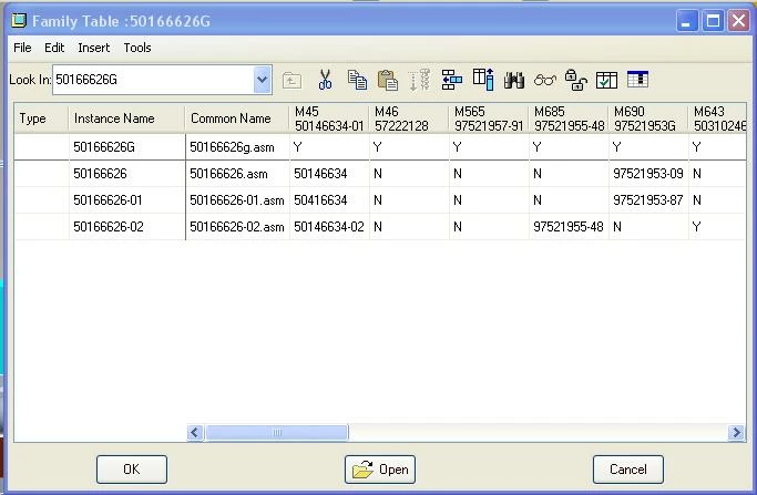

We do it all the time. When you look at the attached file (which is a snap shot of a typical family table, here). Notice that even though the "M45" column has the 50146634-01 in the generic, the 5016626 & 5016626-01 rows calls out 50146634. These are all instances of 50146634g. The way to do this is to assemble one of the instances or even the generic into the new assembly. Then add it to the family table. In the cells for the different instances of the parent assembly you just type in the child instance you want for that parent instance. Kevin Brandt Contract Project Engineer currently at Vapor Bus International
