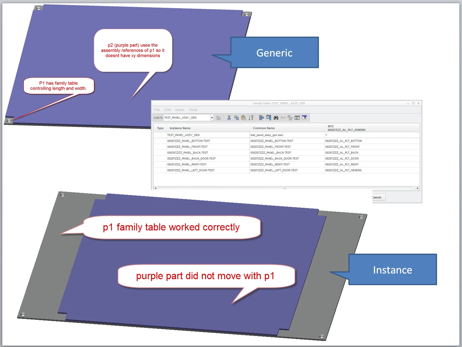

I've got a rectangular part (P1) where the xy dimensions are controlled in a family table.
I have another rectangular part (P2) that I want to be the same size as p1.
I assembled the generic of p1 using default constraints. I assembled p2 on top of p1 using datums. Then redefined the feature of p2 to use the edges of p1. Then created an assembly family table.
When I open up an instance I can see that p1 works fine but p2 does not move. It stays the same size as the generic no matter what instance.
Any ideas on how I can get p2 to change size when p1 does?

Thanks for the responses so far. Hopefully this image will explain what I am trying to do. P1 has a family table and I am successfully calling it out in the assembly family table. P2 has no dimensions because it uses the surfaces of p1. The reference appears to break or does not update correctly when an instance is regenerated. See image. My goal is to get the outer dimensions of p2 to equal p1. I think it has to be a family table because I need to make drawings and I have many instances assembled into a top level.
Eric

What's happening is that you are REPLACING the original P1with another part. P2 is tied to the original part NOT to which instance is being used in the assembly. It would work if you actually drove the dimensions with the same family table rather than replacing. Is there a reason you are not looking to identify a different P2 to go with the different P1's? You do need to have separate P1's though? None of this is how I would recommend tying things together, but if you truly need it you might create a sketch in the assembly that is driven by family table, and use the edges for BOTH P1 and P2. It won't create different parts for P1 though. This is basically a skeleton part methodology.
