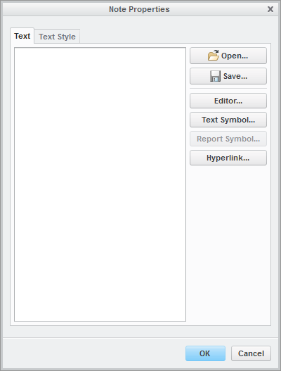

I am not on Creo 3.0 yet, but I remember reading something like this, tell me if it applies... in Creo 3.0 they switched to direct editing (you edit text in the table instead of it opening a new popup dialog like Creo 2.0 used. I believe they added a setting so you can switch back to this box, and that would probably fix your issue. Just guessing based on what you've said so far, and what I've heard. If this is the case, hopefully someone on 3.0 can help with the details.
When editing table like this:
Box in question:
June 16, 2017
In Creo 3.0 you can highlight a table cell (empty or containing text), hold down the RMB and select Properties in the popup menu.  The old Note Properties dialog box will appear

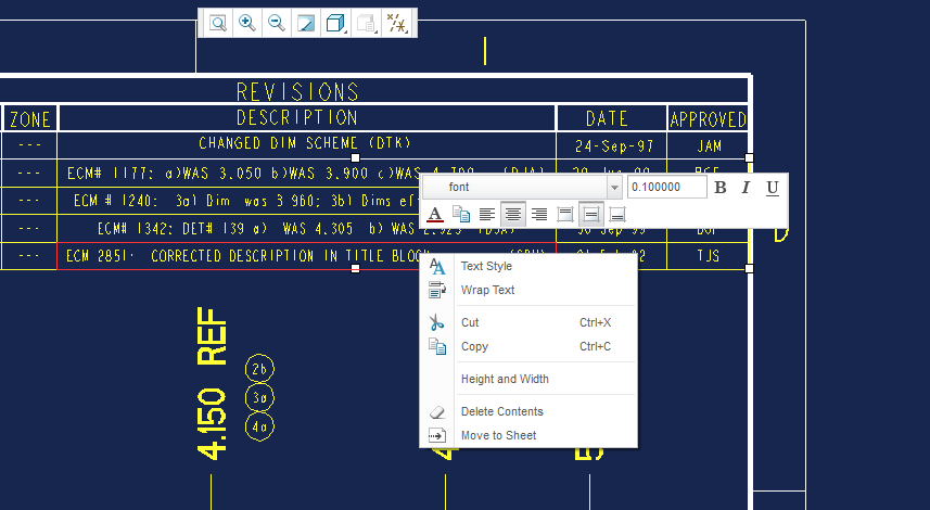

bblair-31-VisitorAuthor
June 16, 2017
When I hold the RMB, I get the following:
