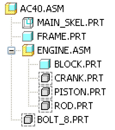

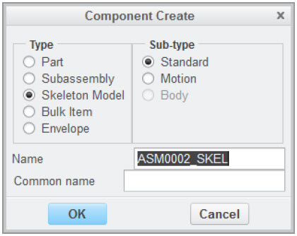

1. Skeleton Models
  • Used for design framework, space claims, interfaces between components and assembly references.
    • Skeletons should contain sketches, curves, surfaces and datums only.
    • Not factored into mass properties calculations.
  • Use in conjunction with publish geom. and copy geom. to share design information.
    • Publish geometry in the source part creates a “container” of references that can be shared with a target part later.
  • Use “multiple_skeletons_allowed” to share design information between multiple skeletons.
  • Create skeletons in subassemblies.

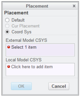

2.Standard Skeleton Model Methods
  • For Skeletons that drive geometry and assembly position.
    • Use “publish geometry” and/or “copy geometry” that references the assembly context.
  • For skeletons that drive geometry only (constraints/connections added later in assembly context).
    • Use “publish geometry” and/or “external copy geometry” that references the skeleton model directly.
    • Allows placement between skeleton CSYS and component CSYS.

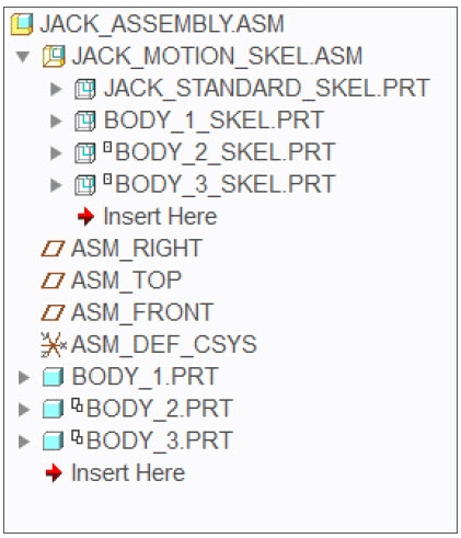

3. Motion Skeletons Overview
  • Used for design framework of mechanized assemblies.
    • Motion skeleton is a .ASM that contains a standard skeleton and “body” skeletons.
    • Standard skeleton contains design geometry.
    • Body skeletons are assigned geometry from the standard skeleton.
    • The first body skeleton created is assumed as the “ground” component and is fixed. Subsequent body skeletons are assigned assembly Connections assumed from sketch constraints (point/point, point/line).
  • Create parts in the assembly context
    • Parts are “attached” to body skeletons and assume their motion definition. No assembly connections are created manually.
Means we can directly copy bottom part geometrical copy ? it looks a great trick
