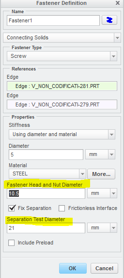

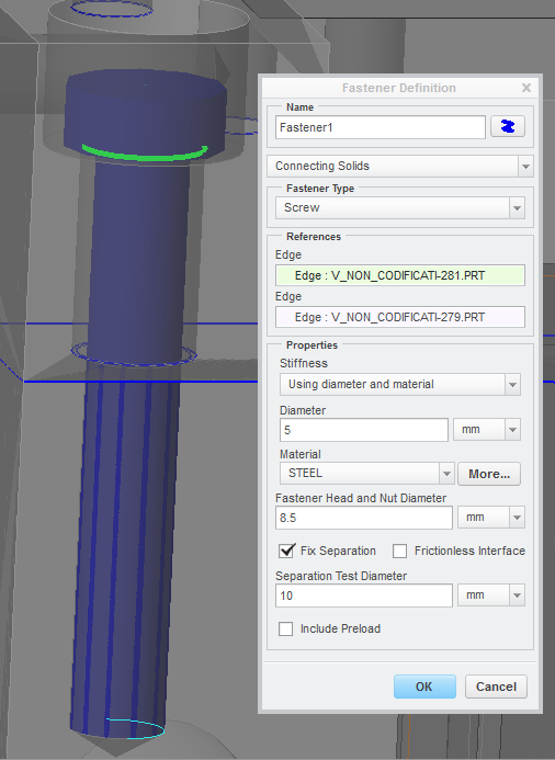

Hello!
Can You Exlpain the relation between these two parameters?
Thank you
6 replies
May 26, 2017
I would suggest that "head and nut diameter" is on the outside of the two clamped components, determining where the bolt load is transferred to them; and "separation test diameter" operates where the two components contact each other, in the middle of the joint.
May 26, 2017
I don't understand becouse this is incorrect
May 26, 2017
Sorry, what is incorrect?
