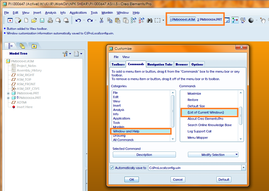

Best answer by KrisR
I found out what has caused this issue.
When adding a toolbar button for "Window->List of open windows" it then causes the issue of not being able to create symbols in the feature tree.
See image below:

KrisR1-VisitorAuthorAnswer
April 9, 2012
See image below:
April 9, 2012
Kris,
I'm gaining good tips from you! I hadn't noticed the Window->List of open windows options before. I like having the open windows as buttons on the toolbar, but I may change my mind later when I have 10 files open and run out of space.
I see what you mean about special symbols using the Alt code not working. When the open windows buttons are available in a toolbar, you can switch between them by pressing Alt+1, 2, etc., which is a helpful shortcut in itself, but prevents one from applying Alt code.
Which would you rather have, special characters and spacing in filenames or a quick way to switch between open windows?
