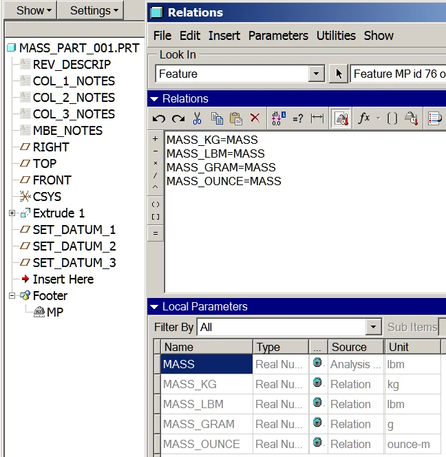

I want to call out the asm member feature level parameter based on the feature name not the id number. I want this to work for any part.
I am trying to remember if you can even do this. I know you can in a note if you include the session ID of the object, but I think it's trickier to get to feature level parameters in a repeat region. (I think I've done it in the past, but I will need to do some digging to remember how.) I think I would instead approach this differently. Have the mass properties feature in your model set a top level (model level parameter) instead of a feature level parameter. This will make it easier to see in the tree (you wouldn't need to expand each model to the feature level) and easier to add to the repeat region.
I created a parameter at the part level named BOM_MASS_UNITS. I also added this parameter to the assembly so I could show it in the model tree.
You do not need a parameter to exist in every model, or even in the top level assembly to add it to the model tree. You can manually add any parameter to the model tree regardless of whether or not it exists or not by simply typing it in. Just make sure you set the type correctly (feature parameter / model parameter / etc.)
[cid:image005.jpg@01CDAD07.02BF9A20] [cid:image006.jpg@01CDAD07.02BF9A20] [cid:image008.jpg@01CDAD07.02BF9A20] [cid:image010.jpg@01CDAD07.02BF9A20]
(These pictures show "Feat Params", but for my relations test above I changed it to "Model Params" to selectively create a new parameter in a few of the parts.
new_weight=asm_mbr_mass_lbm:FID_MP[.2]
You cannot use the [.x] syntax in relations. This can only be used in a table cell, note, or annotation.
Something else to consider is whether or not you really need a standalone feature to calculate the mass. By simply adding the name of the part (or assembly) at the bottom of the Program statement (Tools/Program), Pro/e will automatically calculate the mass properties every time the model is regenerated and update the respective mass properties parameters. The Program statement would look like this:
Part
MASSPROP
PART T1235000_04_03
END MASSPROP
Assembly
MASSPROP
ASSEMBLY T1235000_04
END MASSPROP
