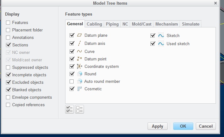

i want to make all time features in ansembly active
i make a default assambly design but i do not sintax for this
what is parameter in config. pro for this ?

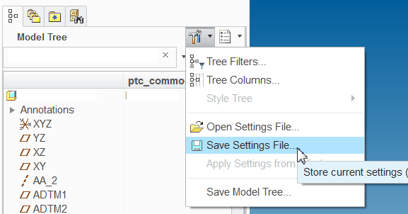

Hello Redro,
You can save these model tree settings into a model tree config file by
Once you save tree.cfg into a location, then you can set a config option "mdl_tree_cfg_file" in config.pro to take the changes by default.
Hope this answers your query.

save model tree configuration in tree.cfg file and set mdl_tree_cfg_file option in config.pro file, for example:
mdl_tree_cfg_file       C:\PTC\\tree.cfg
