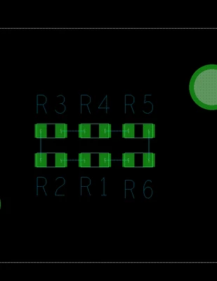

We then tried to create a copy of this slightly weird RES_0402_CUST (it’s slightly weird because the corners are not 90 degrees.  There are very tiny miters, cutouts in each corner.)   We renamed this new part test something.  We then placed it and went to see if this read into board.  It didn’t.
Below is a sample test board assembly in Allegro Cadence R6 is the new copied 2D that is not in CREO library

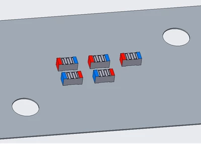

When imported the files into CREO.  It warned that the geometry is missing. CREO gave option to try to sketch build or not.  We tried both options.
What came up was this.  (See below. )  R6,the copied 2D RES geometry,is missing but had no message coming up missing.  We had to dig into ecad log file to see there was a problem.   We’re seeing cases where there are 2D being created no problem, but a few 2D are not being created.  Has anyone else experience this issue?

The obvious solution to this would be to use the hint map file to place the Creo version of the package you created during testing. This should resolve the issue going forward for this package outline. If you face this issue across multiple components, then finding the root cause becomes critical.
Nothing comes to mind as to the root cause based on your description. If you are using the IDF format then query the IDF export from Allegro for that particular package to assess if the geometry may have issues (i.e. it is not a closed shape).
That was one of the first things I wondered.  Was it a close shape?  Yes, it is. But this shape has tiny cutouts in corners and its a small component to begin with.  It a resistor part.
