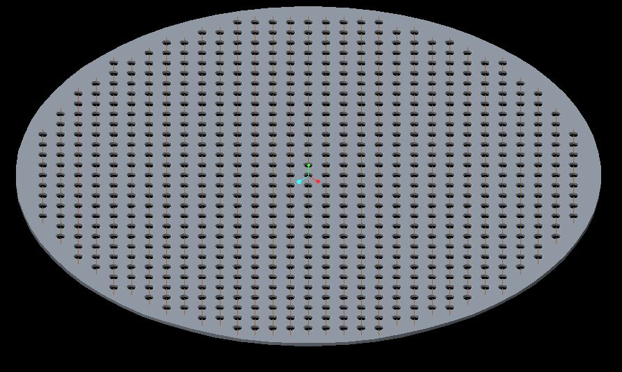

I have create round plate with 220 holes, a single file size is 170 MB. May i know why?
I have used a revolve tool, and hole with round tool then pattern.
I have attaced screen shot, kindly view it. and why the file size is increase

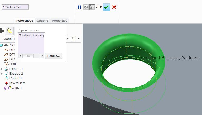

On the plate create a hole and round features.

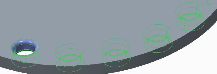

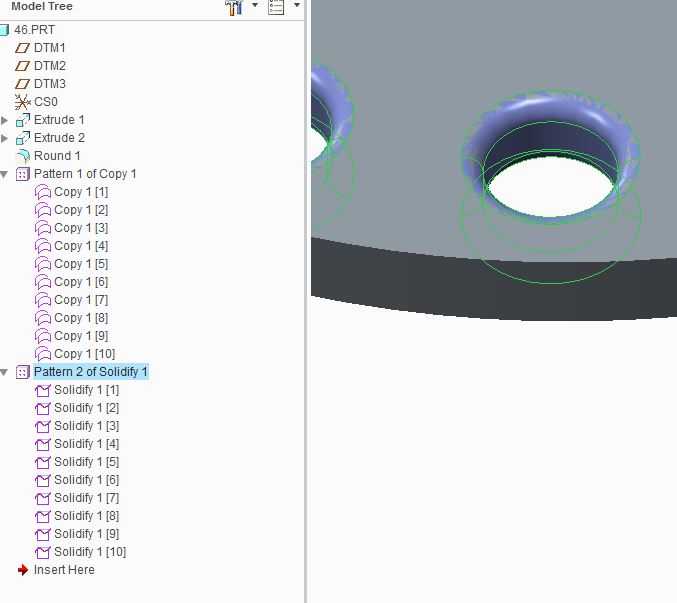

make a copy of the surfaces. then solidify the surface. then pattern the copied surface and then pattern the solidify.3.JPG4.JPG
this will reduce your file size by 60% and regeneration time by 70%.
March 14, 2014
Don't bet on that, Manoja. Even though the entity count may be down, the geometry copy still calculates intersections. Have a look at the discussion linked below where both regen times and file size are really red herrings when it comes to knowing what is going on behind the scene.
Feature Failure with Repeating Patterns
As a matter of fact, I find the copy geometry patterns tend to fail more often than regular patterns.
Although I agree that your statement -should- be correct, PTC's implementation of a "simple copy" is not simple after all.
