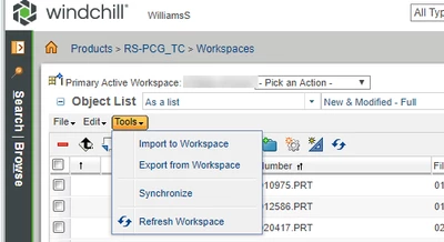

Hello, I've recently had a problem where I would add files to my workspace, but when I open my workspace in Creo, they will only show up if the workspace is inactive. The moment I activate the workspace to open the files in Creo, the files disappear, only to show back up again when I deactivate the workspace. As a result, I am unable to open the files in Creo. Has anyone else had this issue? I've tried making new workspaces, reinstalling and uninstalling, etc. I am on Creo 8 and 9.

In your Windchill workspace browser, use tool synchronize.

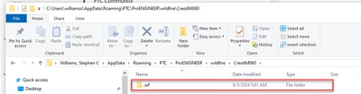

Possibly your local cache is corrupted.
Try deleting the .wf folder  ***WARNING***, IF you have modified objects in any workspace that are NOT uploaded to the server side cache, you will lose those modified objects!
Jun 2, 2024 12:49 AM UTC
Thank you so much for your response! Unfortunately, the files are still not showing up after deleting the cache folder, though I'm not sure if I deleted the right one. I deleted the folder that shows up when you do Creo -> File -> Manage Session -> Server Management -> Cache.
StephenW
Jun 3, 2024 10:28 AM UTC
Use that path in a file manager and delete the .wf folder.
