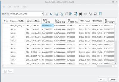

What is the best way to find a dimension within a family table? Is there some sort of search function that can filter through the family table? For example, if I just have a dimension 'd160', what is the fastest way to find it in a large family table.

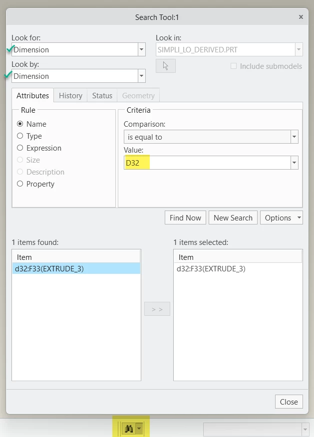

Mar 27, 2025 12:28 AM UTC
You can find a dimension by name using the search tool (binoculars icon). In this example it is used to find D32 in a model. Note the look in and look by settings below.
Mar 27, 2025 3:18 PM UTC
Thanks for the suggestion. Although this only highlights the dimension in the model view. I am trying to find the dimension while I am working in the family table window.

Mar 27, 2025 6:51 PM UTC
I currently have a family table that contains hundreds of dimensions and features. To name them all would be very cumbersome, but if I know the default dimension name, I'd like to be able to open the family table and easily find that dimension within the long list of items. Even if I did name all the dimensions, to be able to find it in the family table is not really any easier to find other than the fact it might stand out because it looks different in the table header. The excel solution is effective, but involves opening another app/window. A built-in search function that takes me to the location of the dimension in question would be the quickest solution.
Mar 28, 2025 12:57 PM UTC
Hi
You can go into the family table & find the dimension you are looking at,
& press add/delete the table columns & click on the same dimension, it will highlight in the window as shown in the picture
