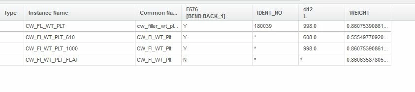

I have created a family table and i want flat length of each instances. I have created an flat instance but it gives the length of the generic part only. can anyone help me.

If you use an asterisk, as in your bottom instance, it simply gives the generic value for that instance, whatever that is. Avoid asterisks and use hard numbers unless that's EXACTLY what you want to happen.
