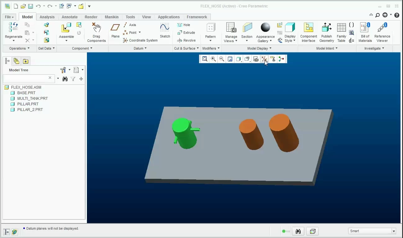

After selecting the appropriate stock for routing the pipe all we have to make sure before routing the pipe is to have the appropriate piping environment set for flex routing.
Once that is set, a single point from an array of points can be chosen for the pipe path as shown in the video.
